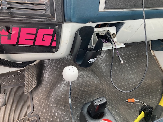

Finally! A cup holder that doesn't take up space on my seat. From Oreilly, magnetic and a good magnet. Says it holds 8 lbs. Derek Beiry at VGG bought these for his mustang for a cross country trip. Works great. Part # PTT0051

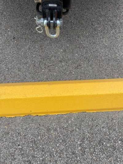

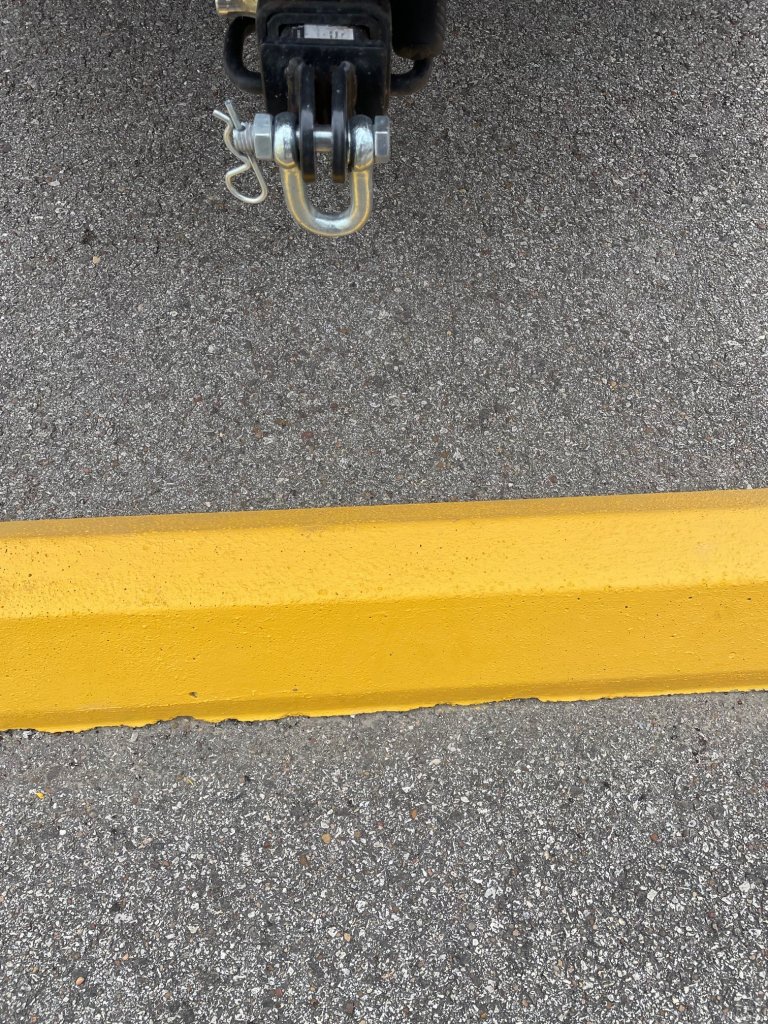

Nice! This front hitch receiver ($238) went on my ‘84 Jimmy pretty easily. I have 4wd so didn’t need a front hitch to put a boat in the lake or anything, but I wanted to put it on nonetheless.
Unfortunately, I do not have OEM tow hooks (and do not want to pay the small fortune they’re selling for online), but I would be curious how they play with the hitch receiver. As an aside, I bought a few of these Harbor Freight tow hooks, which are oriented 90° differently than the OEM hooks, so trying to do something with these may be a creative undertaking sometime soon. All advice / suggestions from the community is welcome!
Thanks for the part number. I would consider removing the stock hooks for the hitch. I had to cut the new air dam that i bought so it would clear the hooks. My bumper brackets are tweaked a little to the driver's side. I may have to fix them. I've looked at those hooks also. I bought the part with the shackle on it and leave it on the rear. It would work great in the front. I'll post a pic. later.
