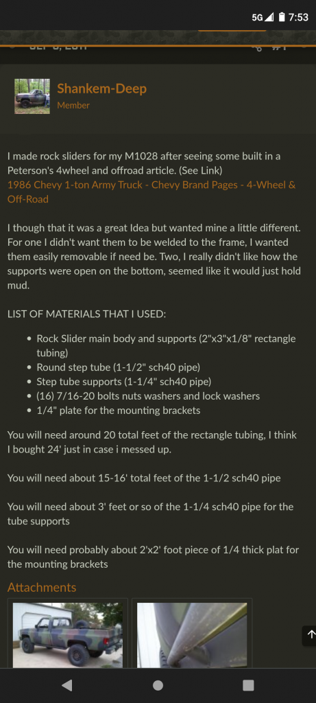

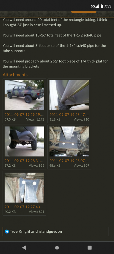

Is that box tube from a carport or something? That stuff with formed ends is usually pretty thin and won't provide any crash protection. Probably won't support the weight of the truck either, for it to be a slider.
This guy actually used.120 wall 1/8" for those that don't know wth that is lol pretty common and a lot of people say they prefer it not to thick so they give in instead of damage to the frame plenty of examples of .120 wall being used but I agree seems thin for my big ol 1ton

That's just for visual I am using a500 3/16 2x3 same stuff the flatbed is made of super tough although that is 8gauge box thicker than most roll cages and rock rails that are normally.120wall
Ok, my next question is what brand carport that was, lol. That's dang beefy for what it is!

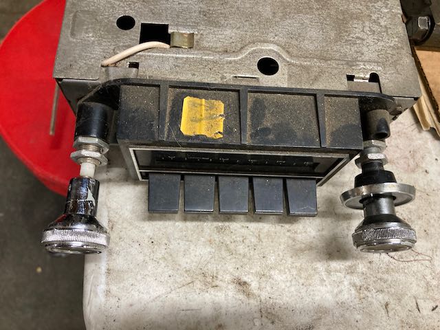

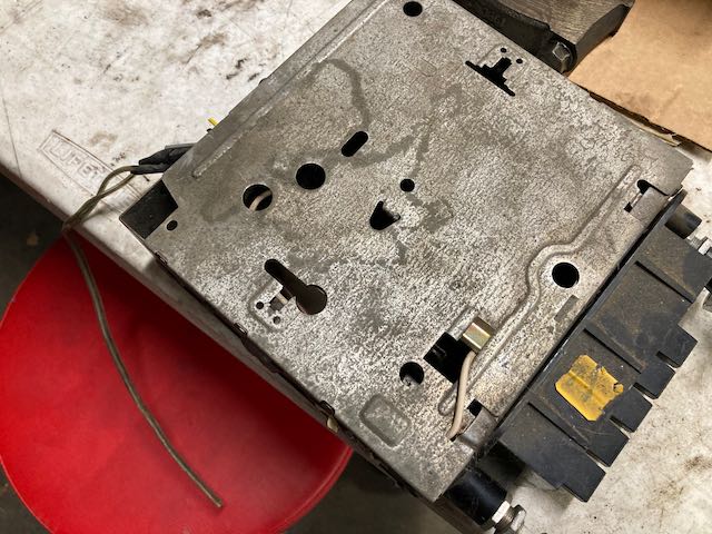

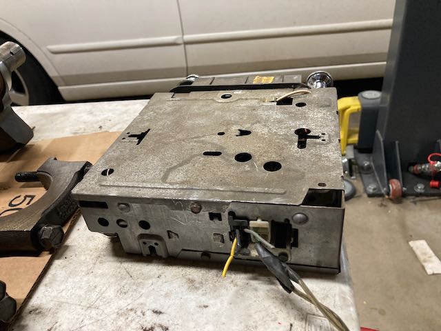

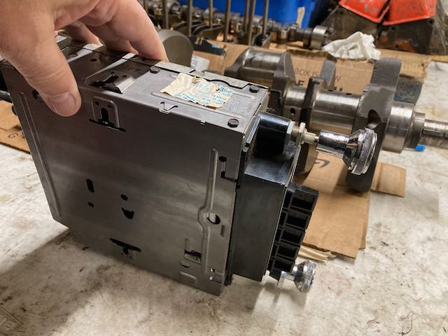

In dash wiring today. Wired up the light for the tachometer, removed the original working Delco AM radio (Does anyone want this?). Fixed a few more things wiring wise. $20 plus shipping?
