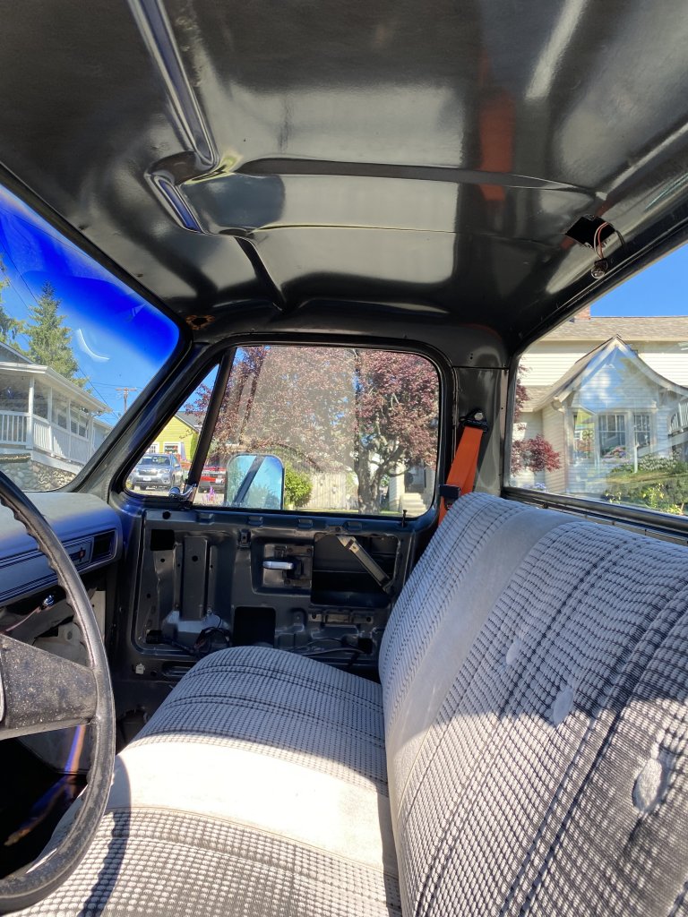

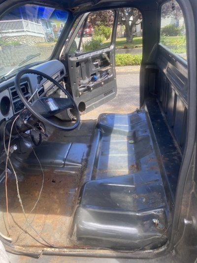

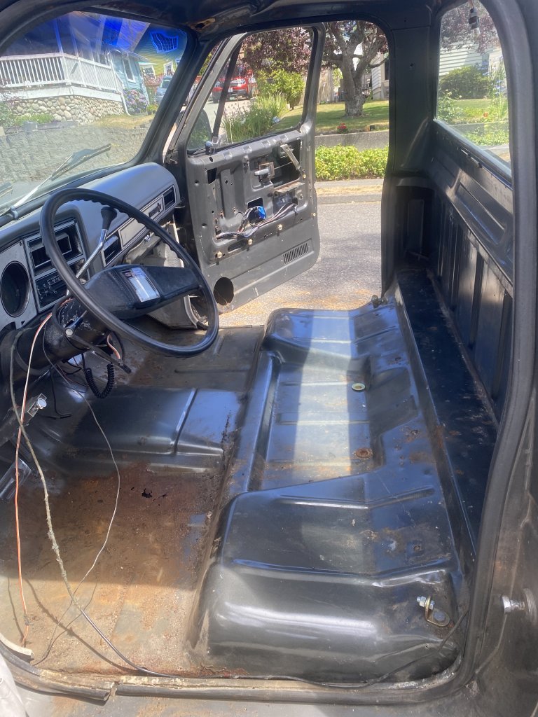

Attempted to tighten my power steering belt…used a ratchet strap this time instead of a crow bar. Worked really well, no more noise. Also decided to unscrew an interior trim piece and 30 min later the interior was gutted. Keeping the seat and will reuse as much as possible of the panels. Will recover the existing headliner board. Driver side floor is rusted through and both rocker panels will need work. Hosed it all out and got it really clean. Smells a lot better! After I fix the floor I’ll recarpet but that’s a ways off. Anyways, thought I’d share pics.

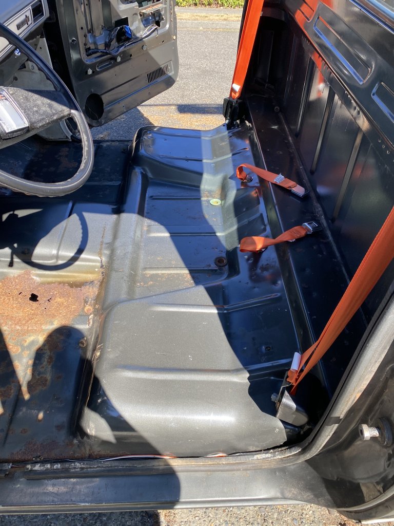

I like your orange belts. 40 years ago my neighbor's dad had an orange Square. Pretty sure it was factory paint, but I don't remember the interior color. Just curious, did GM do a factory interior with orange belts?
Bought this truck from my neighbors and that was the one thing they changed after owning it for 20 years. They didn’t swap the lap belts so I just removed those since I will never use them, they were the same “oyster/mystic” color. I like the orange too, it’s fun but I don’t think they offered it as an option. I would have to look at more brochures and do googling. They are GM belts though, not sure where they bought them.
