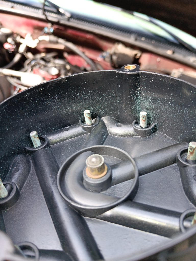

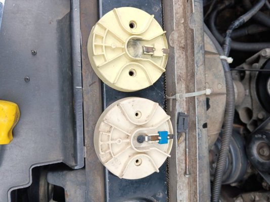

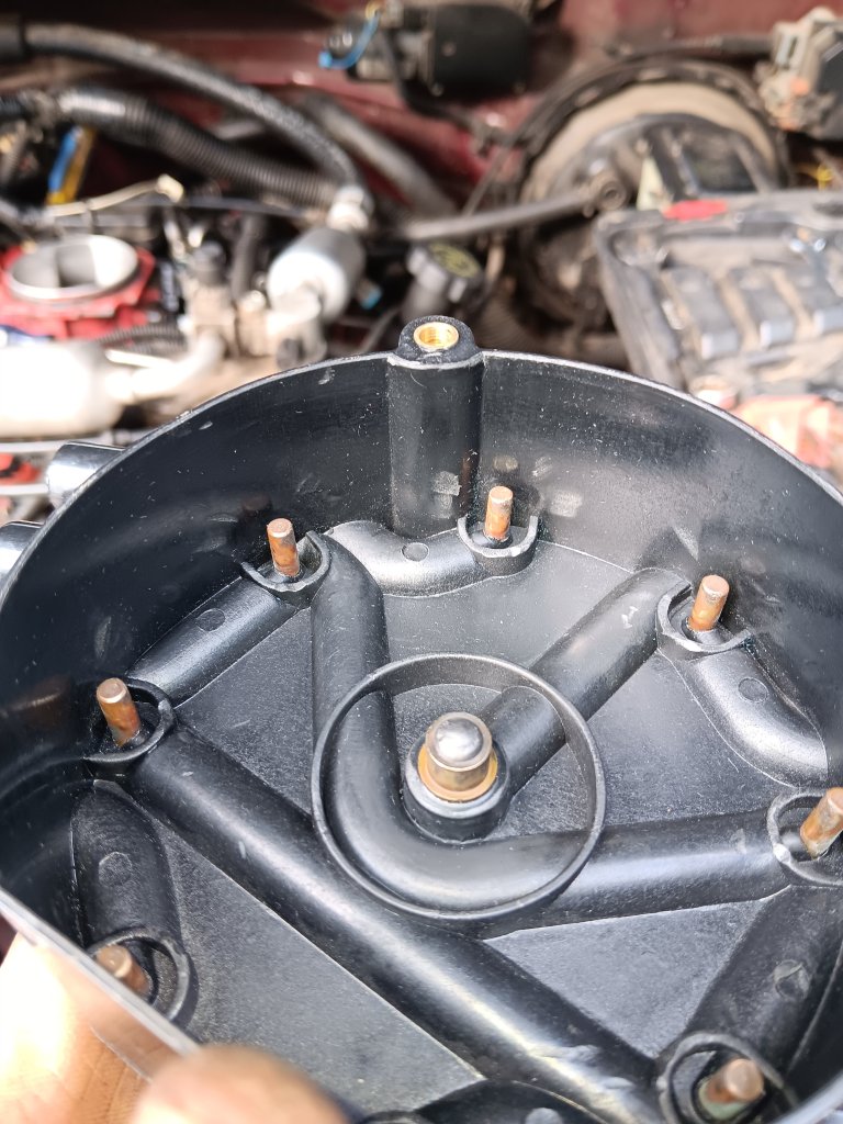

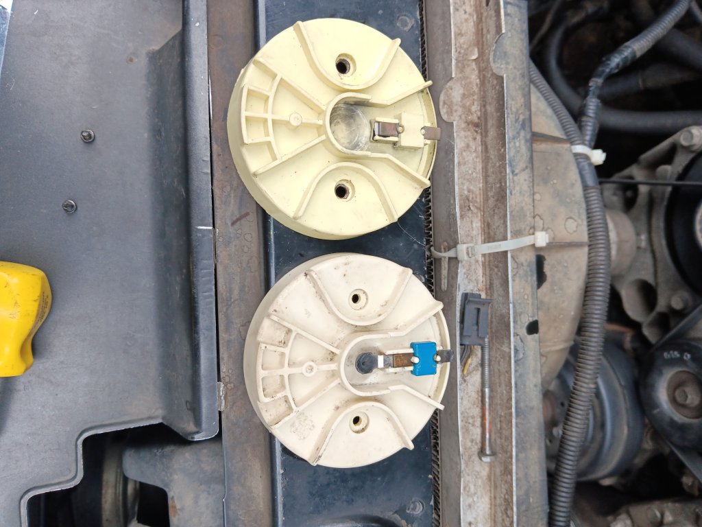

Don't know if this counts but I just replaced distributor rotor on our 99 suburban. Wife was complaining about it missing and bucking. Broken rotor and carbon trail city. Cleaned up cap changed rotor and runs good again.

The vortec 4.3/5.0/5.7/7.4 are all picky about caps an rotors. Next time it needs replaced get a set with brass contacts. I've had better luck with those. For some reason that style distributor is bad to collect moisture an the brass doesn't seem to be bothered by it so much.
