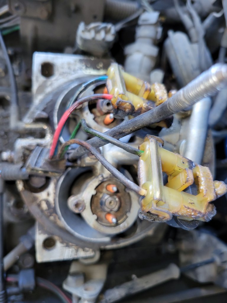

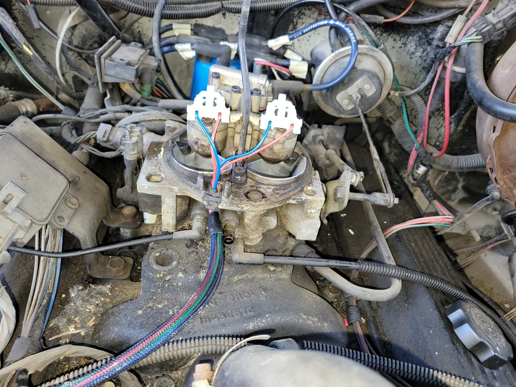

Spent some time wiring in new pigtails for the fuel injectors yesterday, old ones were close to becoming a fuel additive. Fortunately I own a wire harness shop so at least one part of the wiring looks nice. The only part of the original split loom in most places is where the ends were taped.
Also pulled the EGR and found that it doesn't close properly even after disassembling the nozzle and cleaning everything so perhaps that's why the off idle 'stumble'. I figured it was EGR.
Was able to watch the injectors run and they're quite drippy and sad so a pair of those too.

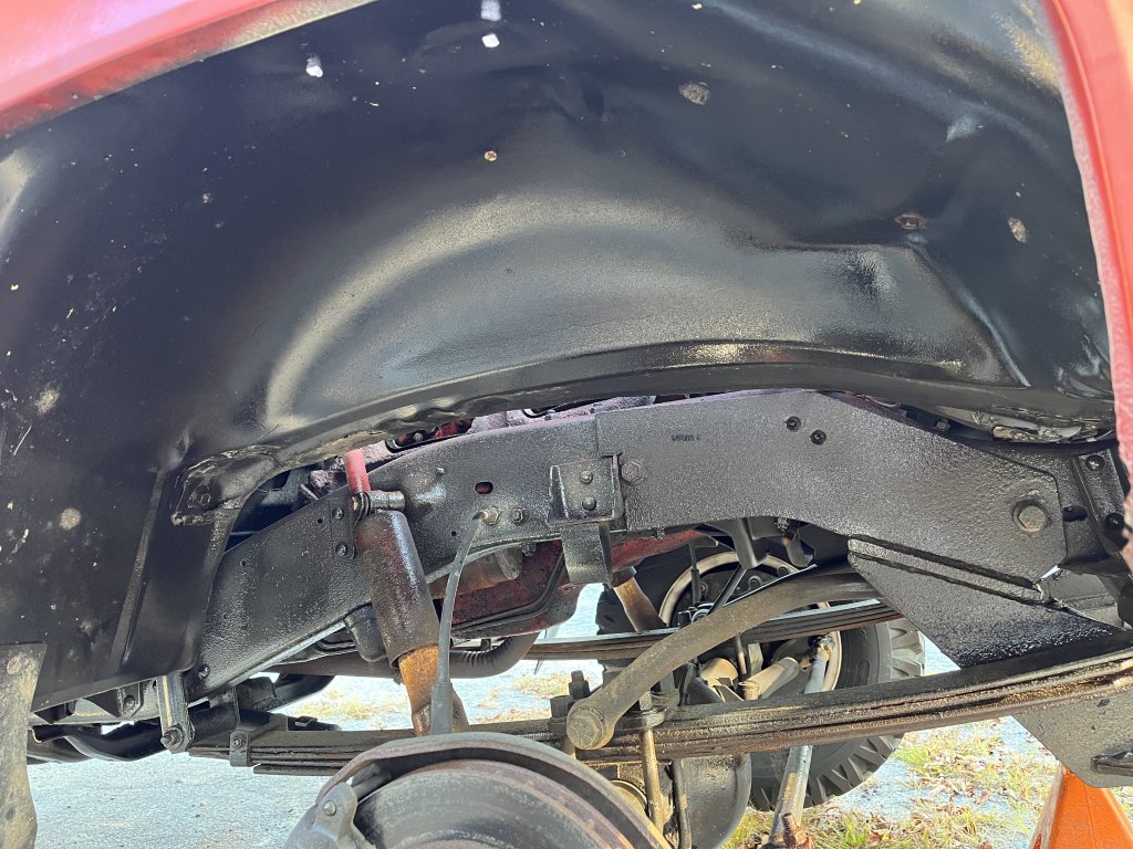

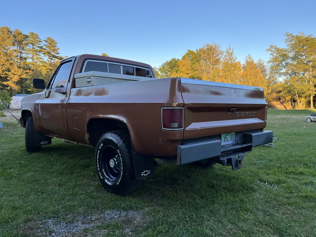

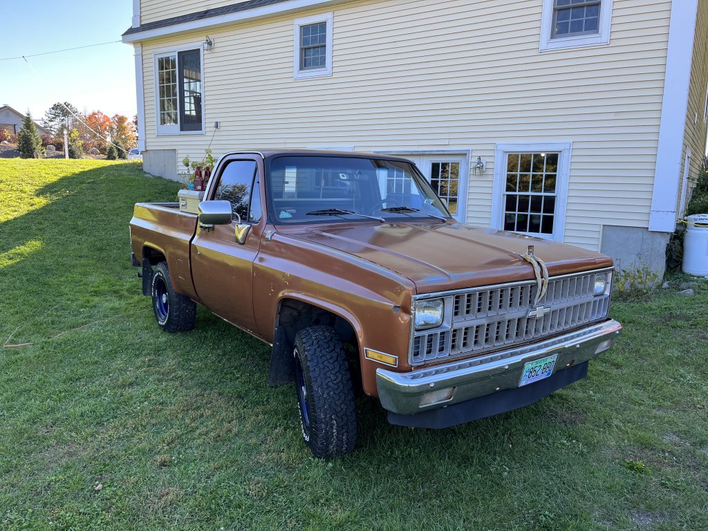

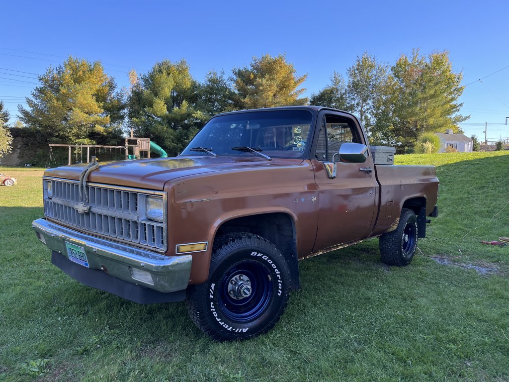

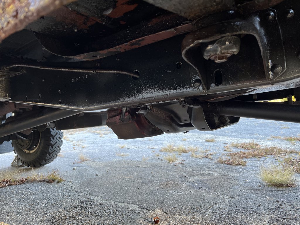

I’ve had a busy square body week. Took apart the holley on my ‘76 to change power valve and gaskets. Adjusted it and the timing that was much needed. Swapped out the non a/c blower motor for an a/c blower motor and fan. WHAT A DIFFERENCE! Oil change, replaced the embarrassingly worn out tie rod ends with a complete tie rod from a parts truck. Fluid film undercoated the whole truck in preparation for winter. And rotated the tires that were chopping from said worn out tie rods.
Fluid filmed the 87 suburban. Fixed the wiring to one door jamb switch for the dome light and gave it a once over check.
Fixed an exhaust rattle on the ‘82, topped off all fluids and gave it a once over as well. Washed and waxed it as we are taking it to a wedding today an hour away and want it looking as good as my wife and I.
