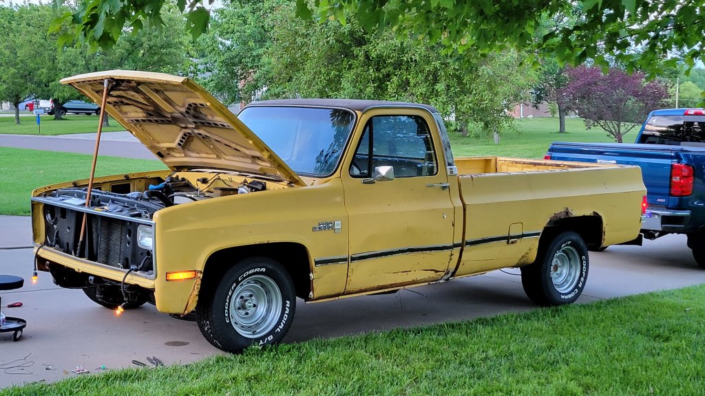

I got all of my lights working (except headlights, have to replace the plugs on the wiring harness first) for the first time in over 10 years!
I really like how the amber lights look on this yellow truck.
May want to look at a headlight relay kit. Super cheap, more power to the lights, eliminates a big load on the OE electrical system and only re uses 1 of the factory plugs (as a trigger source for the relay).

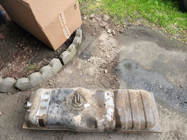

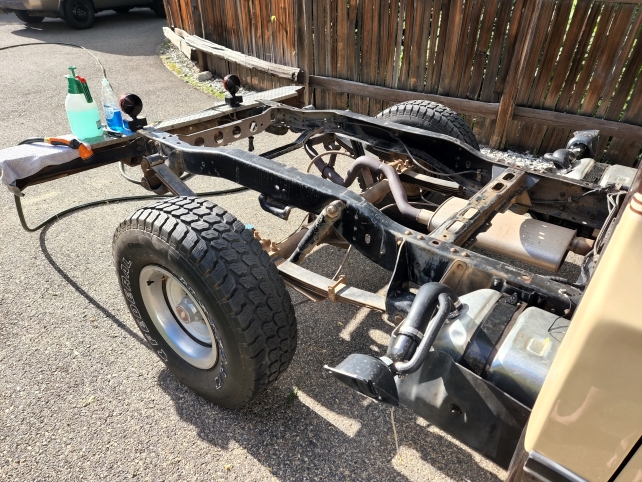

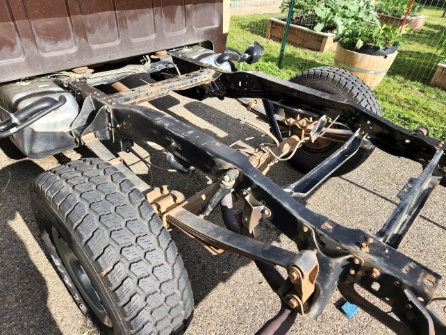

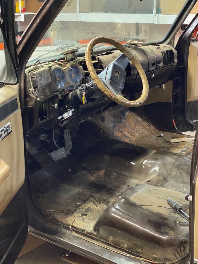

Started winter by pulling the interior and polishing the visible interior paint back. Swapped in two new Spectra fuel tanks w/senders and painted the hanging brackets over the last couple weeks. Both received new rubber fuel lines and clamps along with new LMC necks, mounts, hardware, etc. Yesterday scrubbing the frame down from 38 yrs. of use and it looks purty good.

Looking good. Now's the time to change those rear shocks and spring bushings as well if the are due.
[edit] good time to change the rear diff fluid also. lol just thinking of anything and everything that can be done easier with the bed off..
Did you get those tanks from amazon? On a whim before I ordered elsewhere I checked amazon, the price was a few bucks more but with free shipping.

Yup like a year ago for $83 each. Been on hold due to work and winter. I was able to easily do it by myself though because I bought a bed lift and 2 ton hoist, all on sale of course. :cool:
