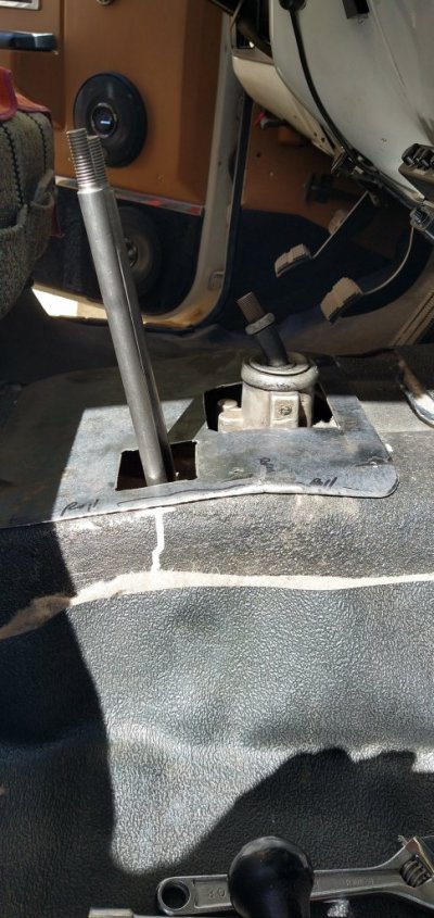

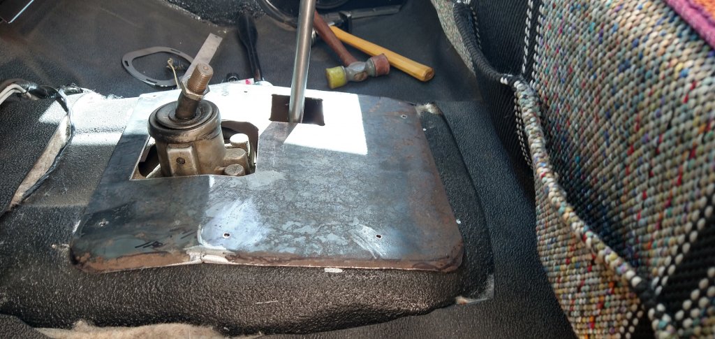

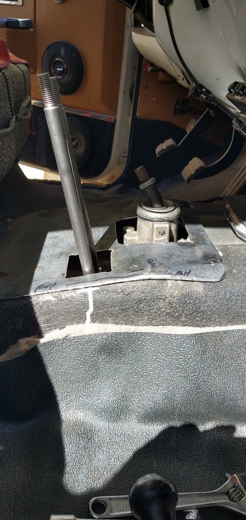

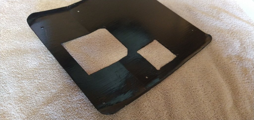

Following. I'm about to order carpet for my 85 to wrap up this trans swap. I made my tunnel a removable access panel version. The plate I made to cover the hole didn't change the overall shape of the tunnel so I'm still good on that issue.

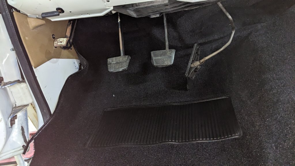

Just so y’all know I ordered my carpet from ACC . Fit was ok but the foot pad piece on the drivers side was crooked . I couldn’t move the carpet around enough to make it straight because then the molded parts wouldn’t line up . It’s off quite a bit which is bad considering the price . Can’t really tell in this pic but it is . I’ll be using mat to cover it up

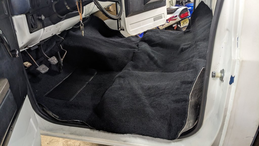

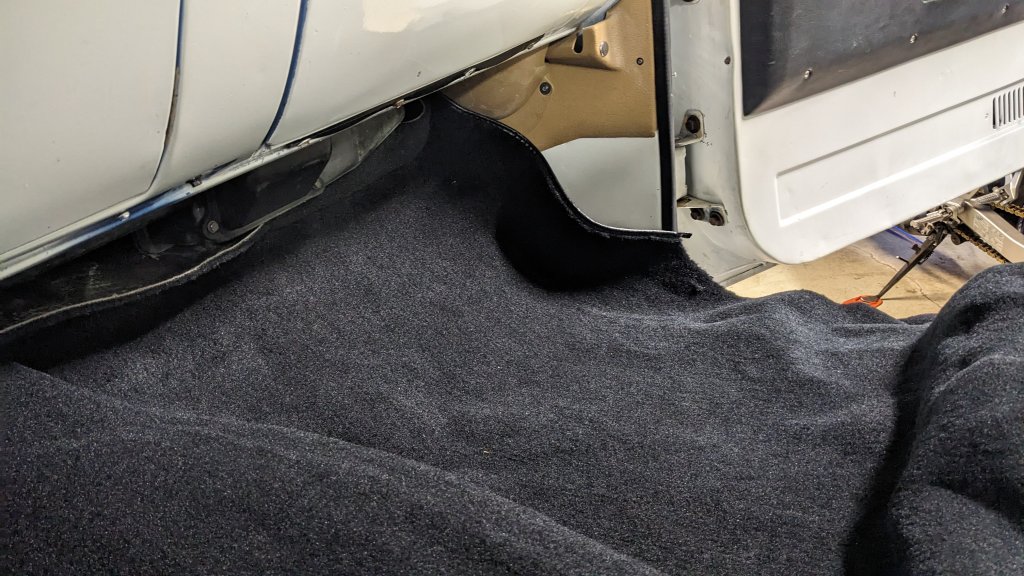

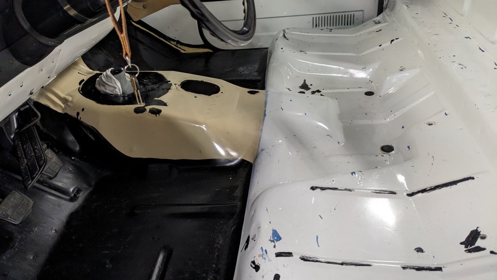

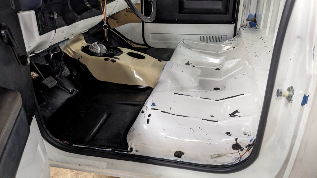

Okay so carpet arrived yesterday. It appears that the C30 manual trans carpet is very close if not the same as the K30 carpet. It has a lot of excess material all around. There is some extra in the tunnel area as well. Since I have no other options...I am going to cut basically 3" on the left and right sides, plus 4" from the firewall. The back looks minor. Sucks cutting the sides as i will lose the finished edge where your kick plate meets at the corner.
