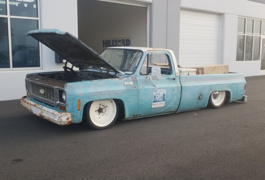

I’d get ‘em! 8.5 and 10 wide yeah? If so the back is fine and I’d go 1/2” wider out to out in the front no problem. Even lowered. Where else you going to get a badass set of new wheels and tires for $1500?
I got about $1600 in mine. 255F 275R Toyos. For reference.
Those would look badass on your truck!
I’m gonna try! I’m furiously adding up funds to draw from, since I just did the posi and then the inner fenders showed up (of course in preparation for bigger wheels). I’m trying to find a way to scoot these wheels past the missus…I’m currently scrounging every penny.
If he sells them before I get to them, I think I’m going to get (now extremely rare) proper backspace wheels off Jegs and then get the fronts on clearance from the Holley site. That would cost me about 1100-ish.

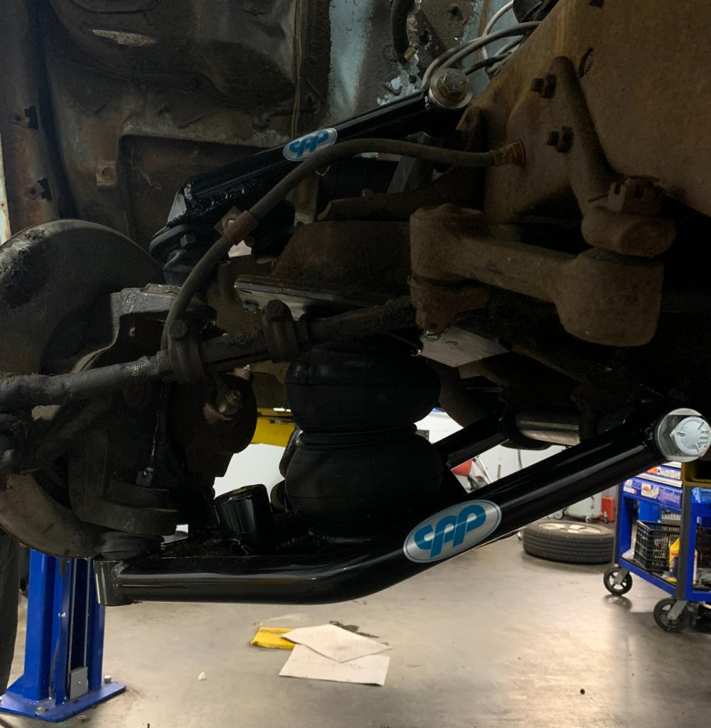

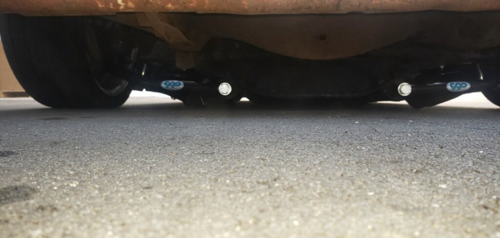

Truck was notched and bagged about 10 years ago. 5 years ago did upper lower CCP control arms. Going to be diving back into the truck at the end of January to re do the air setup and hate myself for previous install choices. Might end up tearing it apart and rear doing the complete rear end but want to enjoy driving it some
Massive weld in C notch with tube stock. Needless to say was a little over zealous lol
