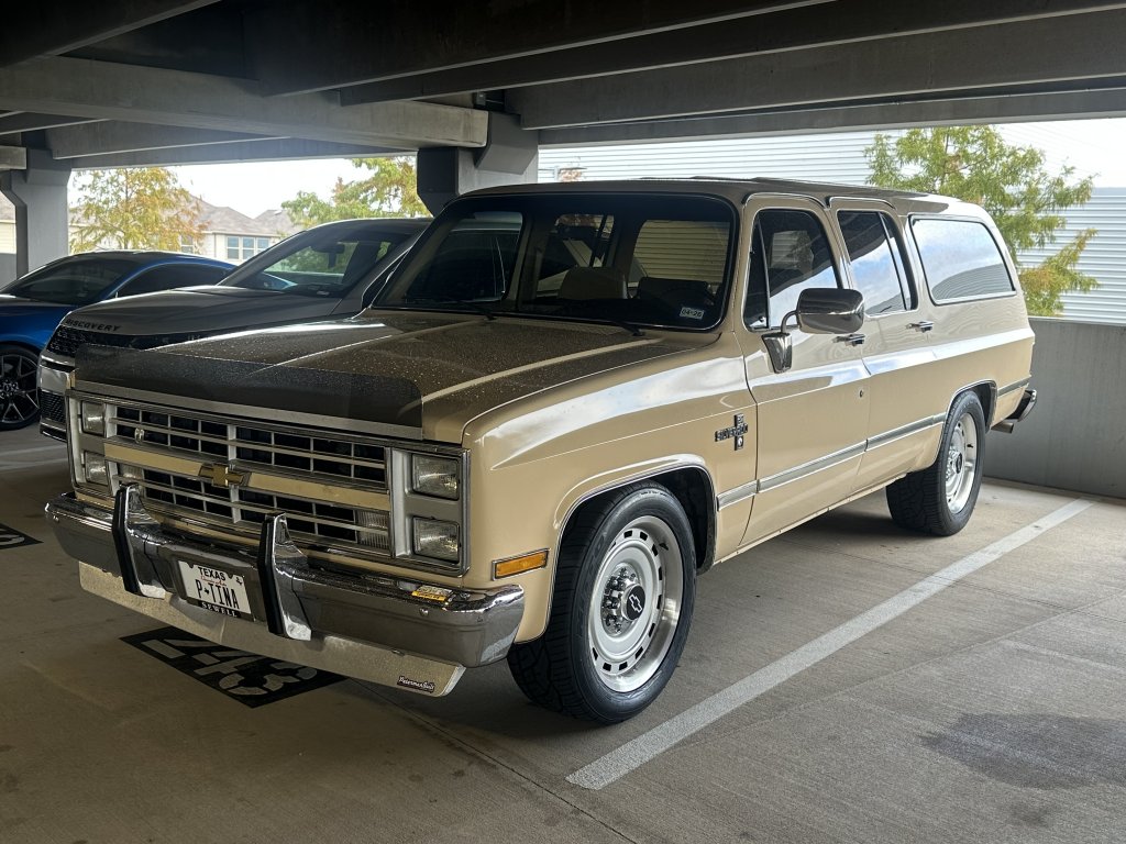

Howdy all,
Old Tina now has around 3” drop in the rear and 2 inch coil drop and 2.5 spindle drop up front. I’m running stock kyb gas adjust shocks and I don’t think the throw is right on these as they are resting mid compression.
Anyone have any lowered shocks they use for c20 or c30?

You have the right shocks on it
Spindles do not affect suspension travel so you don't factor them into shock length. With a 2" drop spring (or even 3") there's no need for a drop shock.
It's there a reason/issue your having that is making you question it? The gas-a- just are going to give you a better ride than any drop shock on the market.
Thanks! Got a bit of body roll and the front end makes some noise when I hit speed bumps, almost sounds like bottoming out .

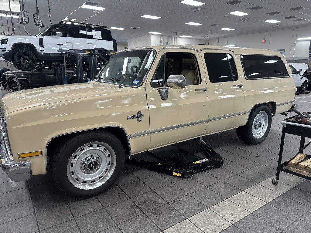

Updated photo with smaller front tires:
A Sway bar is the answer for the body roll
An you'll bottom those tires out in the inner wheel well before you bottom out the suspension. That's probably what you hearing. I bet if look towards inside upper corner of the inner you'll see rub marks. It looks great but those are some big tires for a 4.5" drop. What size are they?

I only rub on hard downhill fast turns, other than that none. The sound I’m getting is a hard rebound clang and bounce back feel. Almost like riding on airbag bump stops.
