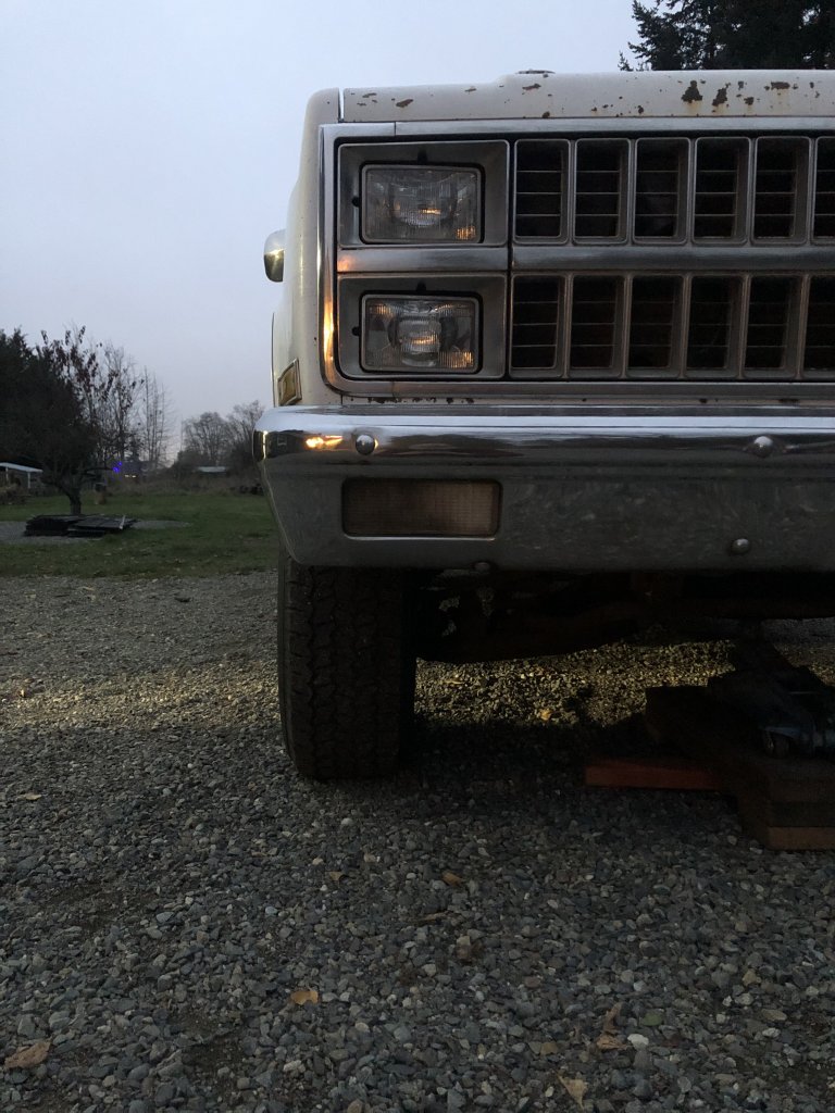

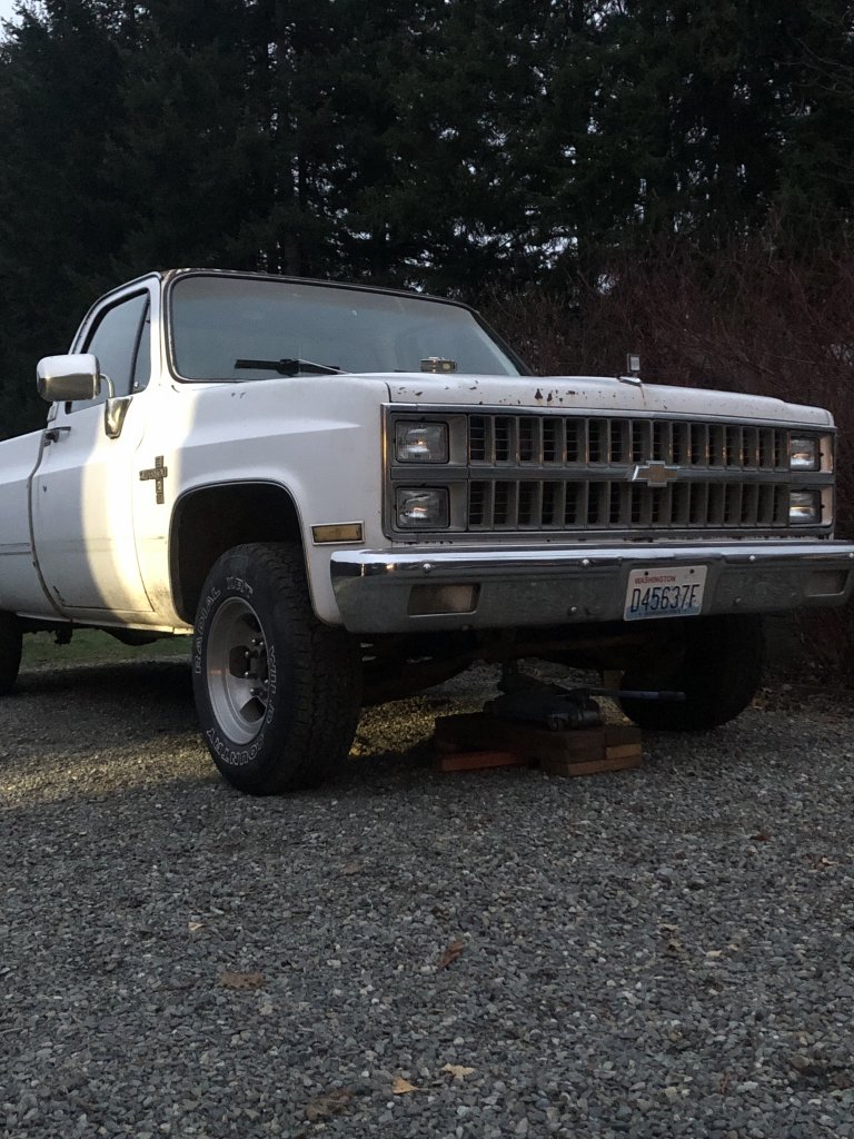

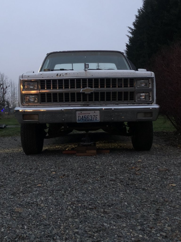

I decided to do a little experimenting tonight. I got the jack out and placed it under the front support. Then came the tape measure and I lifted it up 2 inches. Am I thinking right or will the coil spacers work differently? With 2 inches of lift there is no major (visible) alignment issue. I’m sure there’s a little but not that bad that a shop can’t straighten things out. Maybe I’m wrong, just trying things out.
Sorry the picture aren’t the best.

My opinion 2 inches you'll be fine.A 2inch steel spacer under the spring,set the camber and toe. Let er rip. You can set camber and toe easy with common tools caster is a little trickier.
