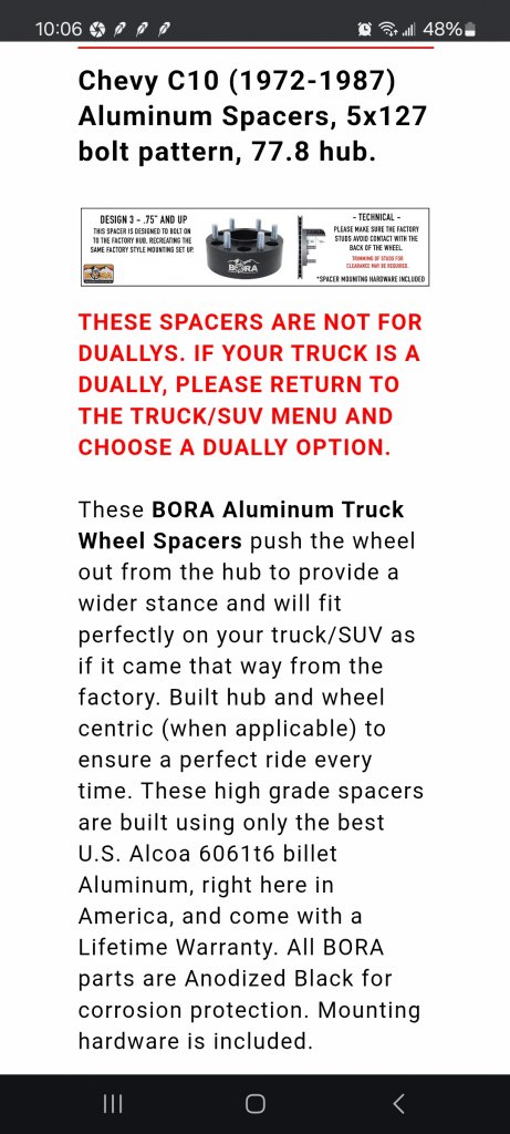

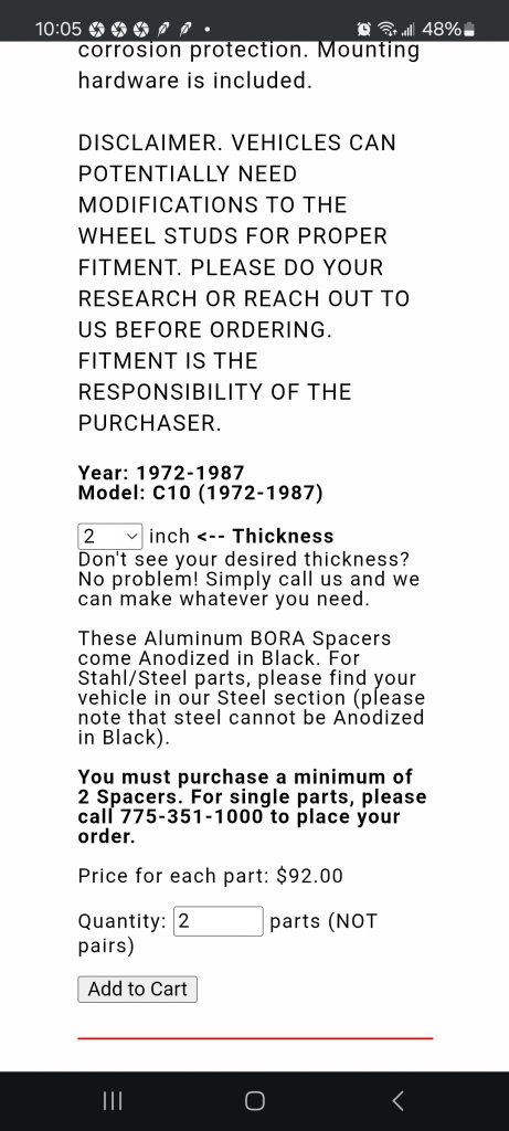

BORA all day - they will custom make any size you need. Them and the Fred Goeske are the only brands I would consider (I run BORA).
