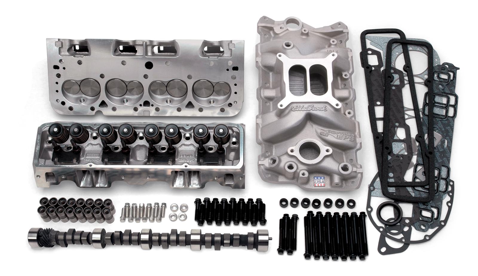

Have you looked into Edelbrock's top end kits? They include heads, intake, cam, lifters, timing chain, all bolts and gaskets. Kit comes with everything you need except rocker arms. You can use your stock rockers or aftermarket rockers up to a 1.6 ratio. I went with Comp Cams roller rockers. Just do it all at once. You said you're not looking to make it a high RPM screamer, Edelbrock's E-Street series have flat tappet cams and are for idle to 5500 RPM. I'm building a 400 small block from a bare block for my '73 C20 and I'm using top end kit #2038, which is rated for 338 HP-389 TQ on a 350 with 9.0 compression. Kit will set you back about two grand.
The intake that comes with the kit is for a square bore carb. If you insist on running that Q-jet you'd have to adapt it or find an intake with a spread bore pattern. You can also buy each part individually instead of buying the kit. You could buy all the parts of the kit minus the intake and buy a different intake.

Do it all at once Mike... like an engine builder would do. I like to set the valves before I install the intake... I find I can see what's going on a lot better regarding getting the lifter on the heel of the cam. Tighten to zero lash and then add 1.5 - 1.75 of a turn down. New lifters... NO OIL ... no problem, just be more gentle finding zero clearance.
With your intake, whatever you end up using, toss the rubber damns for the front and rear china wall. Use The Right Stuff. I like to lay a fat bead on the china walls and let it set up. Then when your ready to install add more Right Stuff goop to the sides and top of your first bead.
