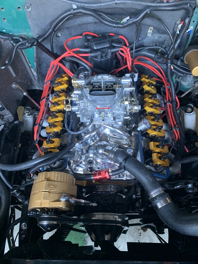

I've just been through the process of installing what you are wanting to do.
I'd do it all in one go if money allows you to, I think it cost me around $2,500-$3,000 for Edelbrock heads, Crane Cam, Crane lifters, crane roller rockers, timing chain and pushrods.
It has certainly "woken" the motor up now, you can feel the difference in power and it launches off the traffic lights a lot harder.
It did take a little mucking around with carby jets and rods but it was all well worth it.

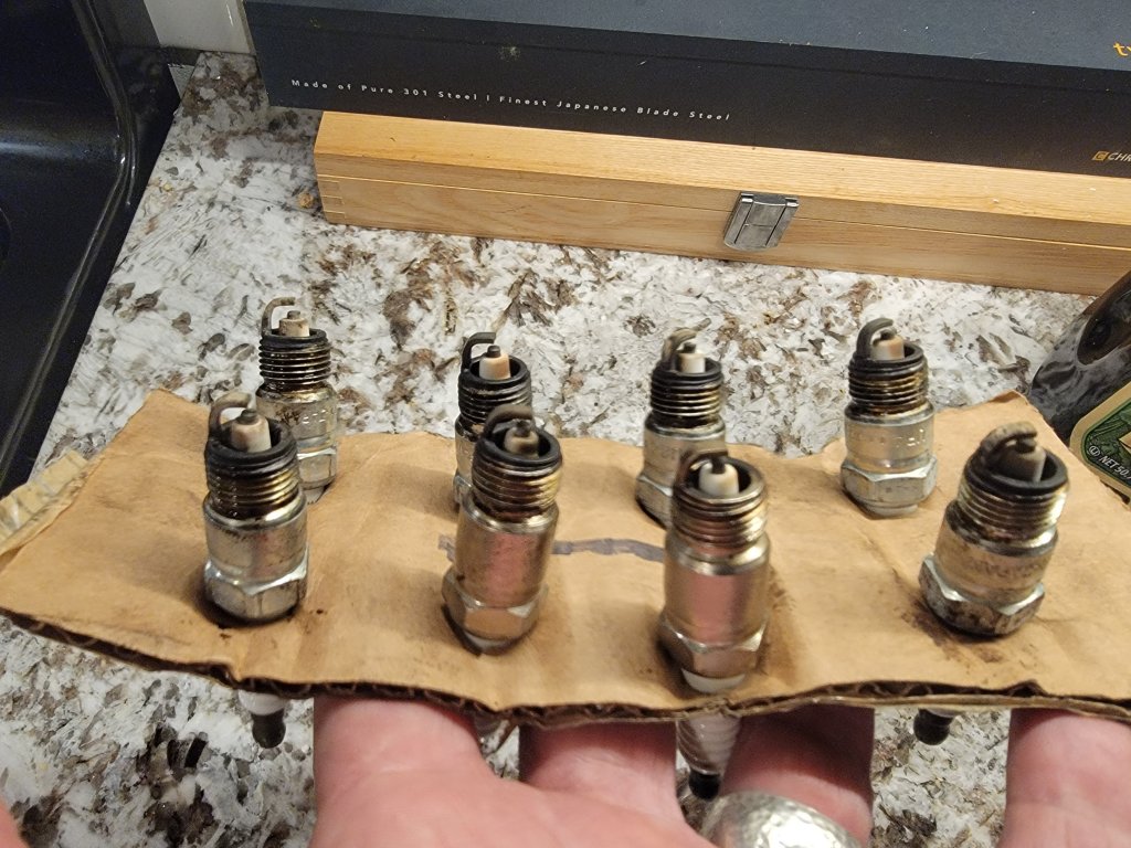

Oh, and I pulled all the plugs (wanting to do a compression check), so I'm gonna post them up here for y'alls opinion. I'm thinking that they look pretty decent, but I wouldn't mind a second opinion!
Thanks again!

So, here's a pick of the plugs (I think I attached it correctly).
Opinions?

im seeing some heat on some but Maybe not complete burn deposits on others
how is your exhaust doing, sealed? No leaks? Manifolds? How is your ignition system? Coil look ok, not original? Module? Those advance weights? How about timing overall? Maybe checked under the timing cover ever?
Hows your AFR what kind of spiritid or lax driving you do? Short or long trips?
Intake I guess maybe there is a sealing issue but at that point I would pull your valve covers and make sure things are in spec and the pushrods are doing ok and things behave right. Maybe we have a pushrod that if you rolled it on a flat surface would not roll straight or you got a valve caked with carbon or isnt sealing perfect. The fact you have some fine, some varied with extremes, makes me think its something effecting a group either by location they happen to be near or the valves to those cylinders arent behaving the way they should but not necessarily catastrophic or anything.
Edit: Im seeing a lot of electrodes varying in distance.. you could have an issue purely based on the ignition strength if those are not equal per cylinder. Maybe not only, but I would be looking at your coil, module, figure out how to use a dwell meter(Idk lol) get new plugs with equal gaps to the right distance, using a good heat range for your use. what kind of oil you use? no gas dilution to any bad amount? PCV ok?

Thanks for the reply. I'll do my best to answer:
When these plugs were installed, I had a pretty significant exhaust manifold leak that was fixed (headers) about 100 miles ago. Additionally, I lost an ignition module literally the same day I installed the headers, so there might be something showing on the plugs from that fun little experience on the side of the highway. She seems to like the timing at about 11 degrees, and I'm all in at about 2500.
Not sure of the actual AFR numbers (been tempted to get a gauge, but haven't yet), but I tuned her with vacuum prior to the header install. I'm definitely going to be dialing that in again after I get the new intake put in. And she's a short trip kind of truck. Just cruising around on the weekends, with some spirited stabs at the go faster pedal.
I'll be pulling the valve covers this morning and checking rods and lash. I'm thinking that the valve guide seals may be trying to give up the ghost on me. They're 38 years old, so while I'm in there, I'm thinking of going ahead and replacing seals. I'm getting little puffs of what looks like white smoke (possible condensation) when she first fires up, but settles down after a minute or two. It doesn't look like a head gasket, (I've worked on a few blown gaskets), and it doesn't look like that. Thoughts?
I'll be going back in with new plugs today. If I recall correctly, I was having an issue with a cylinder or two not firing when I resurrected her, and was swapping plugs to see if that made a difference. It didn't but I was at wits end. Once I figured out what the issue(s) were, I guess I forgot to change the two plugs back. lol Standard dino/diesel oil, and no gas smell or taste. PCV!! Damnit, I bought one when I brought her back, but never installed one. She's probably running on a oldy. I'll check that this morning as well, and put a new one in upon reassembly.
I'll let y'all know how it goes this morning, and try to upload pics along the way as I do.
Thanks again!
