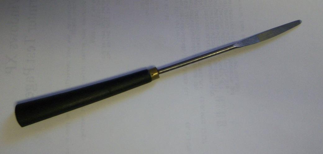

:flipthebird: with your lathe and your mill !!! :roflbow: If I had one, I'd make all my own bushing drivers. I have been known to even make a driver or 2 out of wood with a holesaw drill bit. The deal with wood though, they are usually on a 1 or 2 time use and then you need to make another although its not real hard. I'd love to have a lathe for modifying drums, sunshells etc. I'd be rollarizing every damn transmission I built, using torrington bearings intstead of thrust washers.

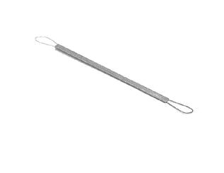

On the low reverse, I use air to get the piston out, but I have never used anything other than my hands and my handy dandy rootin tootin art tool to push the piston back into the case. I don't use a lip seal tool. Those things with the wire are to flimsy. Altouugh, you must be careful with the tool I use. You get to aggresive, you can put a slice in the seals. I've done it a couple times myself. Here is what I use for a lip seal tool.
attachment.php
This is the industry standard lip seal tool. When using this type, I'd only get a couple builds out of it, then had to get another. The wire gets bent up fairly easy.

I think you might have misread that hotrod. I know what your using for lip seals but the low reverse piston that goes in the case doesnt have an acual lip seal, it just a square seal. I know alot of people that use the compressor to reinstall them just pressing them inplace and a few others that use a block of wood on each side and just push it in or tap it in with a hammer and lots of gel.
But your lipseal too with the wire, I really cant understand why you can only get a few builds on them. Are you using the seal protectors for the inside of the pistons? or are you using your tool for both the inside and outside lip seals?
