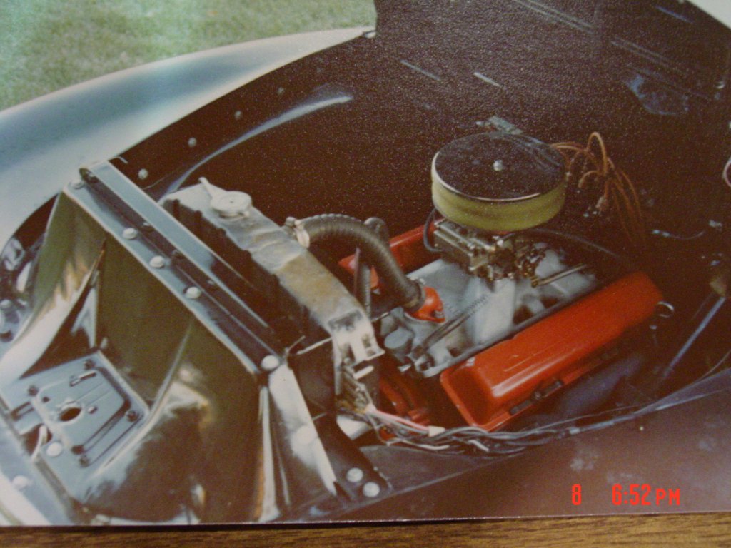

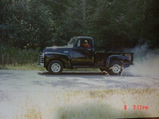

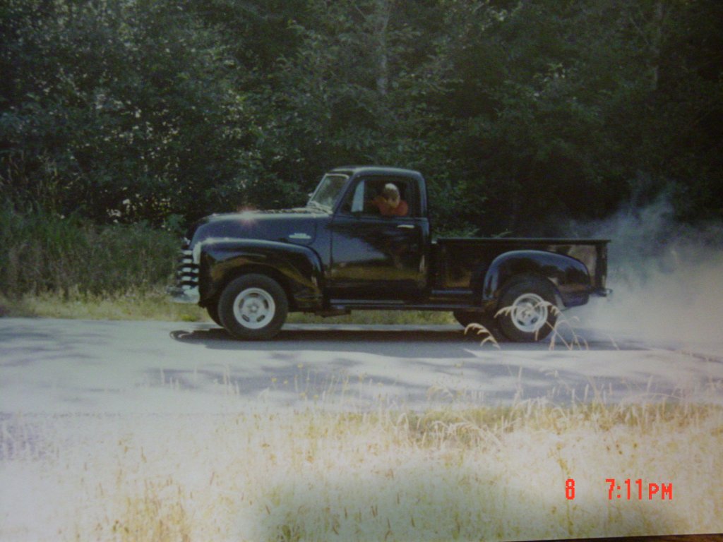

Very cool writeup Hotrod, now I know you a little better. Wish I was closer Doug, would give ya a hand. I to had a Muncie with Hurst comp plus in a 53 3100 PU 63 car rear
end, 4:56 posi, it was fast but not real good at high speed, but hey that 283's never blew up, and it saw 8000+ often. I built that truck in my 20's did all the work myself, learned lot's and caught the bug. BTW, I drove that truck with that Muncie behind a 235 with split exhaust, (of course I did it myself!) and a Carter YF. Drove it to Bakersfield, then to New Orleans, Gainesville FL. Going home Fort Collins Colorado, it was -13 heater could hardly keep the windows clear, and the Vacuum wipers worked slow, remember those you ol' coggies out there! Kalispel, then to home in Selah, WA. Never missed a beat, except I ran out of gas on the long viaduct over the swamps with all the alligators. think by Shreveport LA. Geez.
