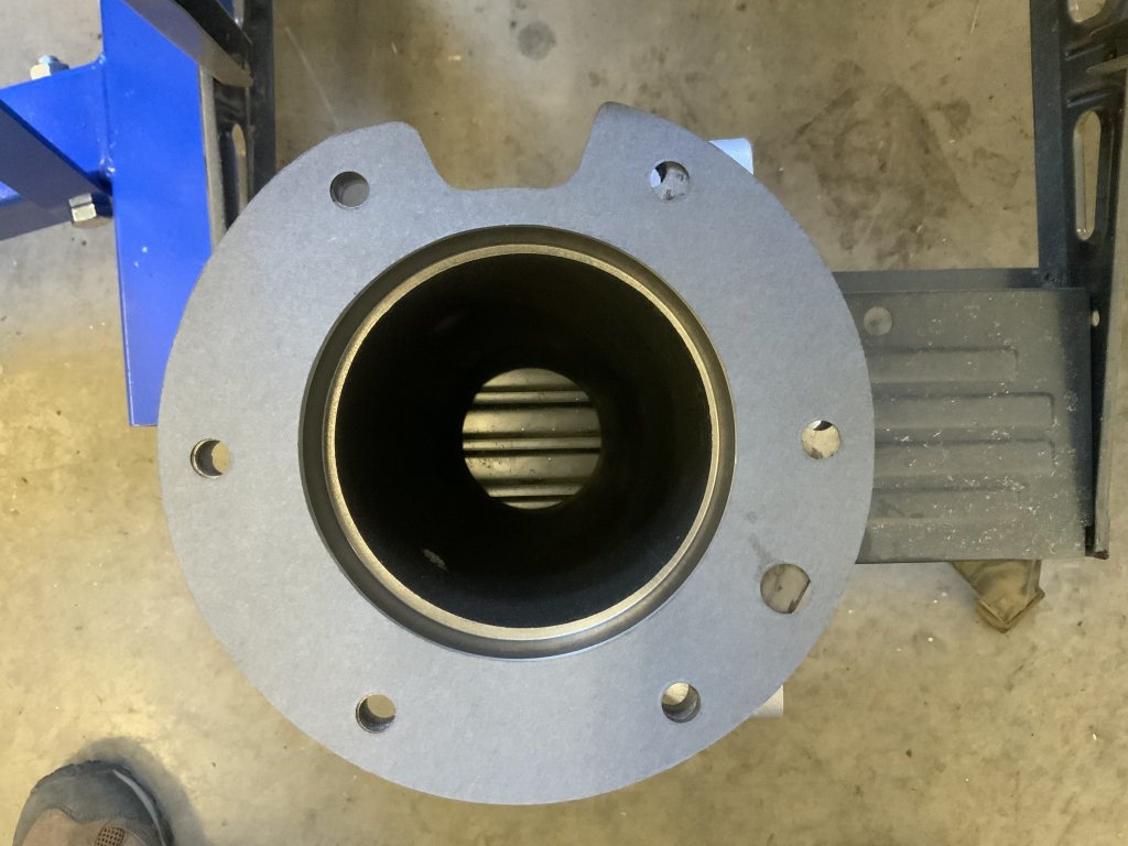

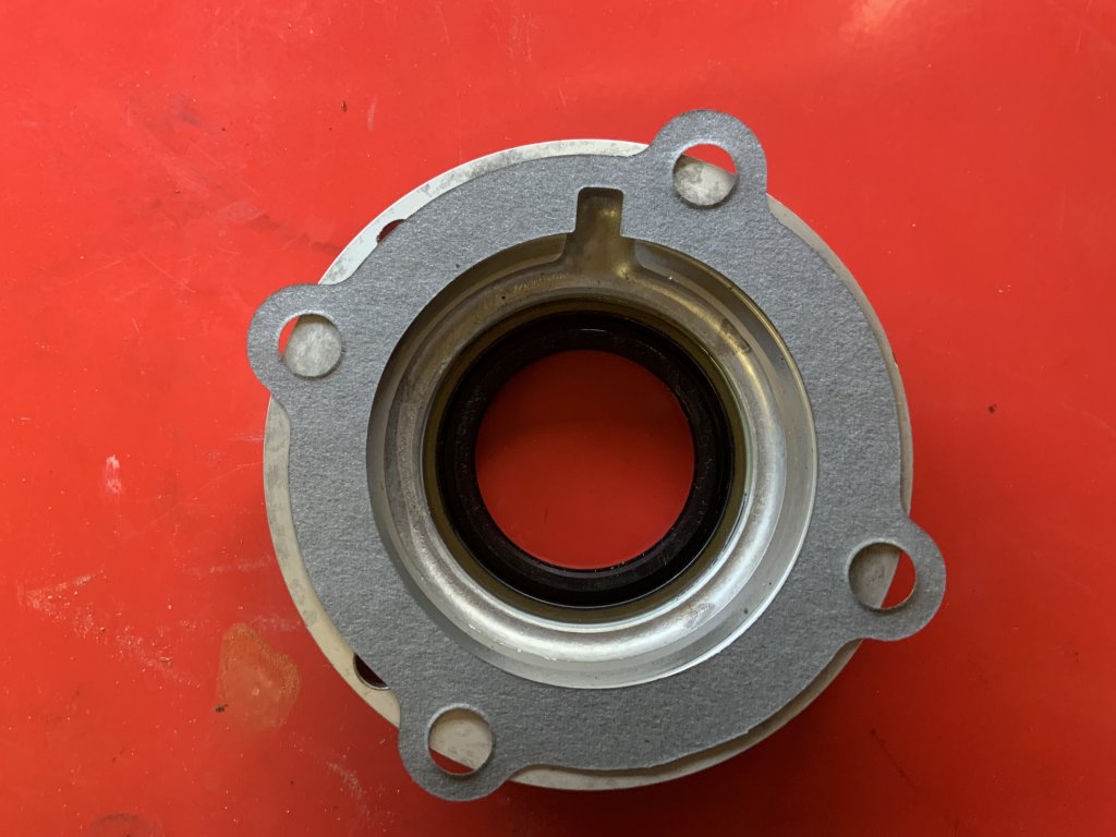

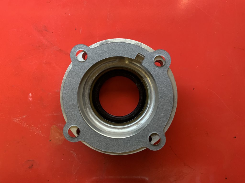

I finished replacing gaskets and seals on my 85 round pattern NP205 using one of the many "universal" kits that supposedly fits all models from inception to 1991, and found that the gaskets for the input seal housing and adapter to case were the wrong size. The kit I used was from USA Standard Gear #ZTTSK205
The only kit that specified 85-91 GM 32 spline was from Torque King 4x4 (TK2052), but it is unclear as to whether it would have the correct gaskets, but at 3 times the price of the others, I didn't find out.
The rubber yoke star gasket for the 30 spline front output is not available, so I re-used my old one with a little help from some RTV. I bought some gasket material to make the other 2 gaskets that wouldn't fit.
