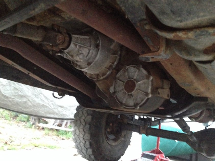

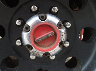

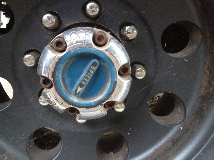

After reading a couple other threads I've come to find out that my front Dana 44 has locking hubs....(I went outside and looked.) That however, from what I've read, doesn't mean that it's part time. Am I right? Attached are a couple few photo's. What T case is this? Also Why does one of my locking hubs say Spicer and one says Ford? Either way I'll be changing those to Warn locks soon!

Does look like an NP203 to me. Someone may have put a part time kit in it if you're able to run with the front hubs unlocked. There is nothing wrong with hose hubs. Both are Spicer OEM hubs. Just that Ford wanted to take credit for the Spicer hub so they had their name put on it instead of Spicer.

that is most definitely a np203 because it doesn't have that little plate with three bolts
like this np205
upload png
Yea, I looked for images so I could determine what the little plate w/ three bolts looked like but I finally ended up finding a picture of a 203 that matched mine. I do appreciate the replies because I am trying to still figure out what I do have in this truck.

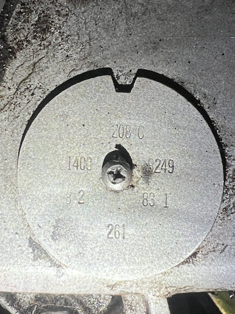

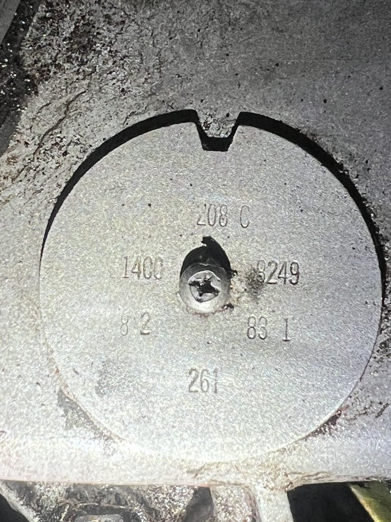

It looks like it may be a 208. Is there anything else I need to know that you can tell by the photo?

There are no dumb questions, only dumb answers. My dumb answer is your truck most likely has a New Process Gear transfer case. It would have come from the factory with a tag like this:
If the truck spent any time in the salt belt, the tag probably melted away.
Post a picture of the transfer case, someone will tell you what it is.
So if I read this right I have a 208c transfer case with a 261 gear ratio. Correct?
