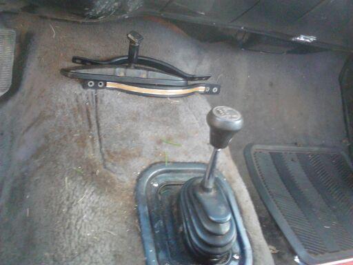

So, for mostly on-road use and the occasional off-road (not boulder climbing or mud pit racing) use like driving through a field to check on cows or go hunting, is there anything very wrong with the NP203? I'm in the process of bying a '79 K1500 with the full-time T-case (I assume this is pretty definitely an N203). See pic.
I looked at one recently that had manual hubs installed on the front to allow 2wd operation. What's the advatage to that if, during normal ops, the open center will put most all of the power to the back anyway?

NP203 is just fine for using the truck for things a stock truck was intended for. The big benefit of using locking hubs on a truck without a part-time conversion is less front tire wear and easier turning. With locking hubs and a part-time kit you get the previously mentioned benefits as well as less front drivetrain wear and a slight improvement in fuel mileage.

So, since this is where I started my NP203 questions, I'll send one more. My truck was delivered this morning and I decided to road test it by driving to work. So, just to make sure I wasn't about to set off down the interstate in 4lo-loc I thought it wise to feel each detent of the t-case and be sure I had selceted 4hi for my pavement drive. So (I'm an engineer, forgive the OCD here), with 4hi-loc, 4hi, N, 4lo & 4lo-loc there should be FIVE distinct positions to the selector handle. Where the F are they, about 1mm apart? Do you have to be rolling uphill in reverse for some to engage? I can only really feel two positions - I'm assuming that's 4hi and 4hi-loc.
I see people write "the shifter sucks" regarding NP203. Can someone explain exactly what kind of "sucking" these folks are referring to and any potential solutions/workarounds (NOT replacing the case).

Your experience is exactly why people say the shifter sucks. The linkage is probably crusty and needs a good cleaning and lubing. There is also an adjustment procedure if cleaning/lubing doesn't help.
