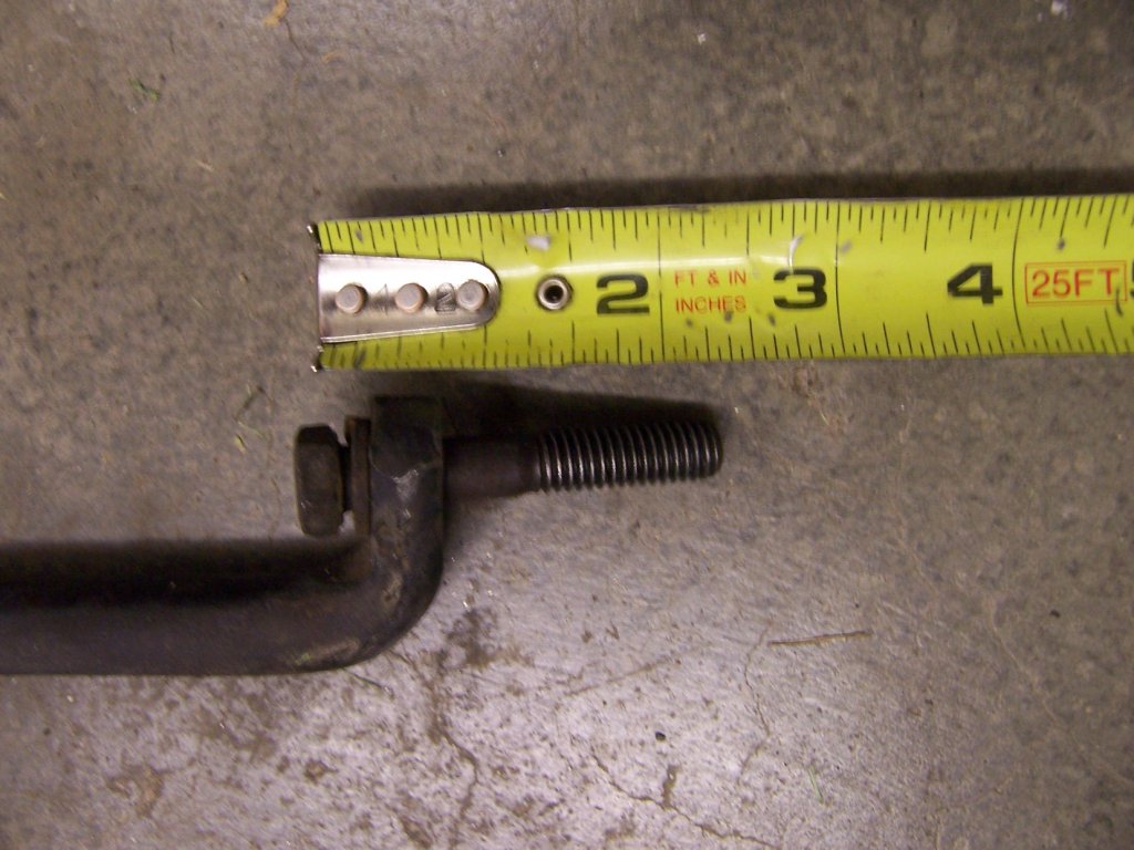

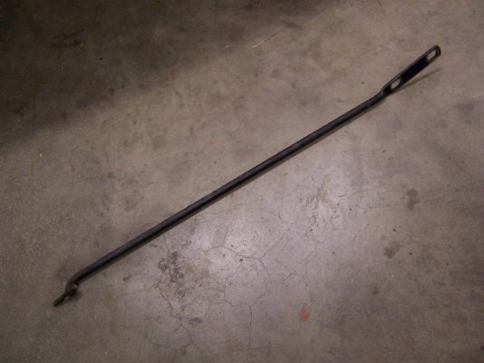

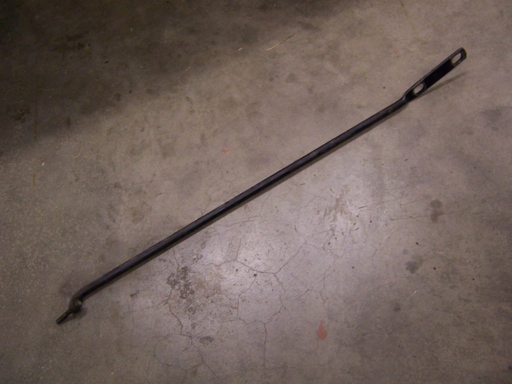

Doing some work have that bar off. It's an 81 K20 350 V8, 350 auto if the same. Rear holes are slotted, start bolt in slots then tighten at the motor then go back and tighten at TC. Blue loktight won't hurt but really look it over for something else loose. Rather uncommon for one to fall out that quick if installed correctly.

You should not need to pull the starter.
3,705
6,699
No need to pull the starter as John mentioned. I "was" using a standard 3/8-16 hex head bolt. It was 1/4 inch longer than the rest of them to account for the thickness of the rod. Never had an issue. Then I swapped to a 4500 and 205 t-case and the rod doesn't fit anyway. There has been a LOT of discussion on whether that rod and/or the t-case to frame (older versions) make any difference. If I had it and it fit, no harm using it otherwise I wouldn't give a rip. Now that I have said that I expect my tail housing will break off on the way home from work today and leave my t-case lying on the freeway. :shrug:
