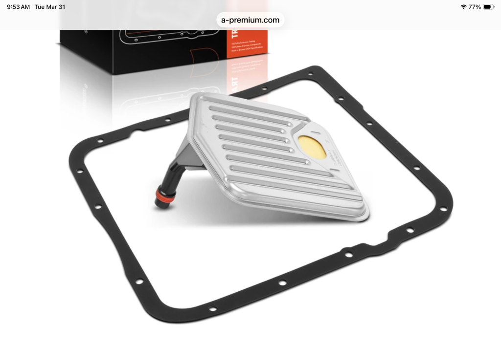

BTW the reddish brown rubber gasket you can see in the picture is steel reinforced.
The gasket got stuck inside my transmission body and was a nightmare to remove. Considering having the service done next time
The filter gasket does like to stay in the transmission. I have had good luck using a very small flathead screwdriver or a pick to slip in between the gasket and the transmission and deforming the gasket to the inside. Then it drops out easily.
