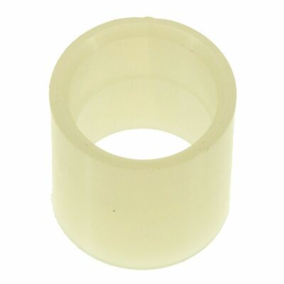

Ya know they got that piece of plastic that connects the distributor to the oil pump?
Bet it's that deal and the OIL PUMP SHAFT is beating around in the distributor hole. Best way to tell?
Replace the plaztic. It's two bucks.
Getcha a new distributor gasket too - just for kicks huh?
It'll be fun! :D

That's still the fix.

Hello, this very interesting! what does it take to replace this piece? Thanks!!
Rusty Nail
Jan 29, 2015
9,796
9,705
Rusty
350sbc
Remove the distributor.
Getcha a magnet on a stick and pull out the other piece.
Connect the two with the intermediate shaft guide and re-install.
No sweat. You'll need a distributor wrench.
