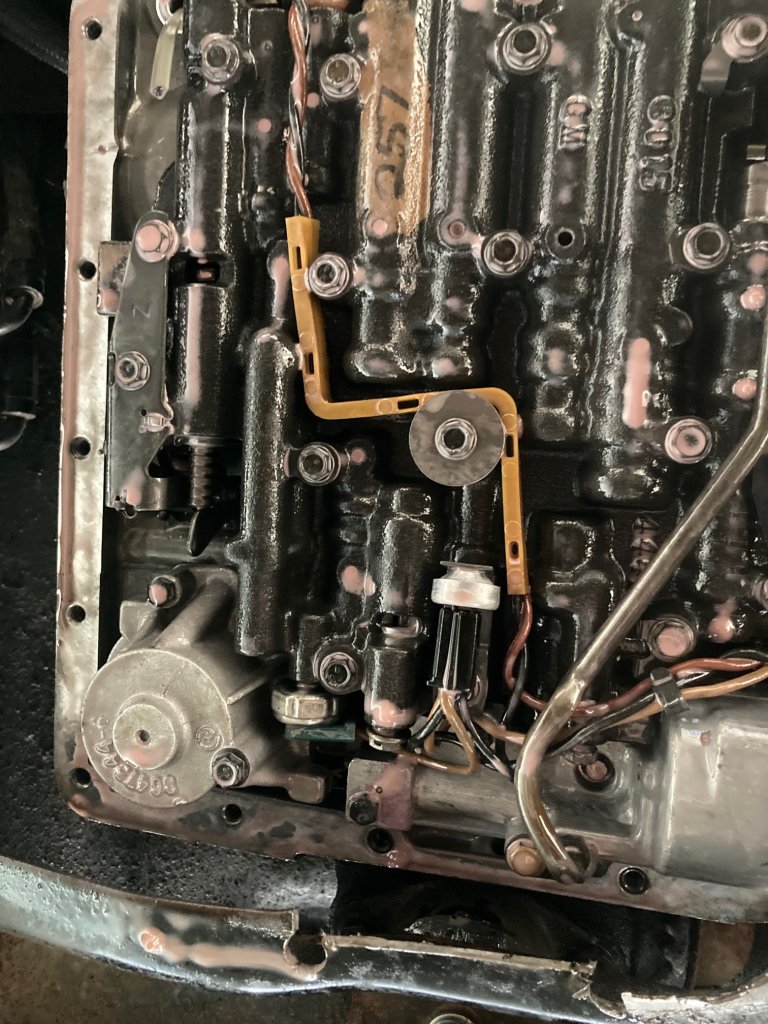

Good morning all,
I have just bought a 1987 C10 longbed here in the UK.
It has been fitted with warmed up 327, with a 700R4 transmission.
Am I right in thinking the 700R4 would have been factory by 1987?
There is no wiring going to the transmission - the square plug is on the gearbox, but no wiring to the box.
So - I have no 4th overdrive wiring.
I also need help identifiying which 700R4 I have - normally open or normally closed pressure switch?!
I have had to remove the sump pan already - so hope the attached photo helps someone help me ID the internal wiring.

You have 4th gear without the wiring. What you don’t have is a locking torque converter.
Use a continuity tester to determine if the pressure switch is normally open or closed.
TCI, Painless wiring, all make lockup kits of if you don’t want to make your own. bow tie overdrive makes a really nice one, but it’s also the most expensive.
