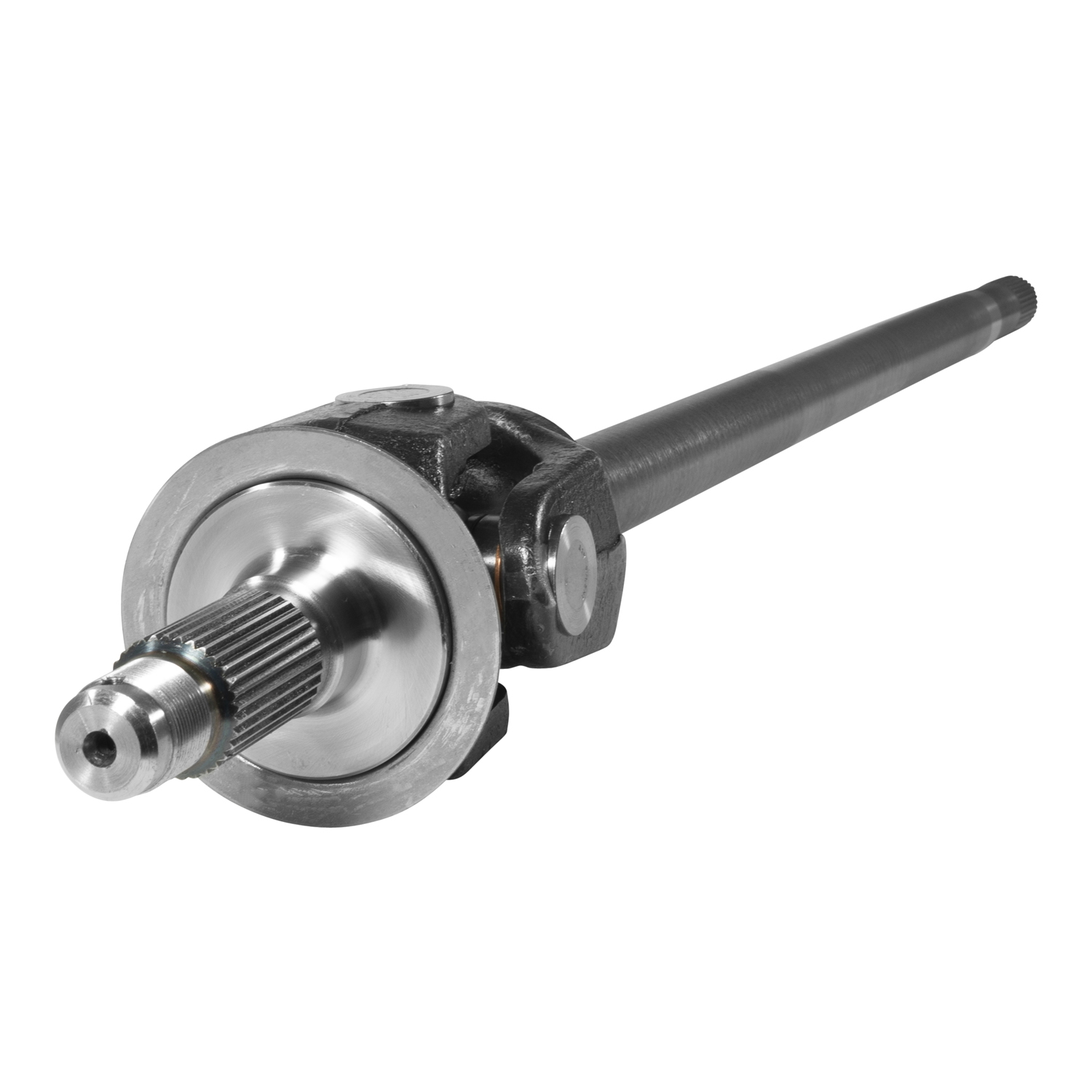

That's a great question. I did a search using my vin# and it came up with this Yukon set.
Are you showing the same? I would definitely give them a call direct to confirm.
That’s for the more trick cro-mo set. The ones I’m looking at are more of a stock replacement and come with u joints pre-installed.

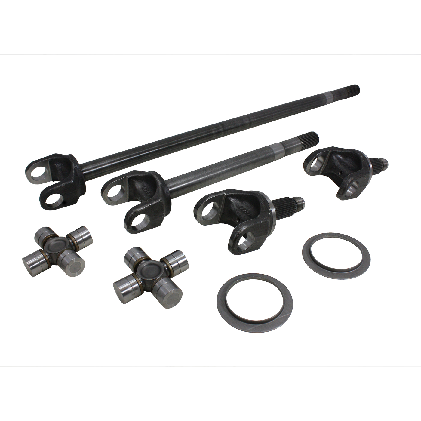

So, more like this one?
Yep, that’s what I came up with. I was just concerned from typing that into summit and a couple other sites they’re listing it as a 12-bolt vs 14. Is the AAM 9.25” a 12-bolt R&P? I figured they were counting the diff cover bolts, but maybe it the ring gear bolts…

I don't honestly remember off the top of my head. I think that is the right one but I would definitely call and make sure.

I ordered them from a vendor that had them in stock. Worst case scenario, I can return them.
