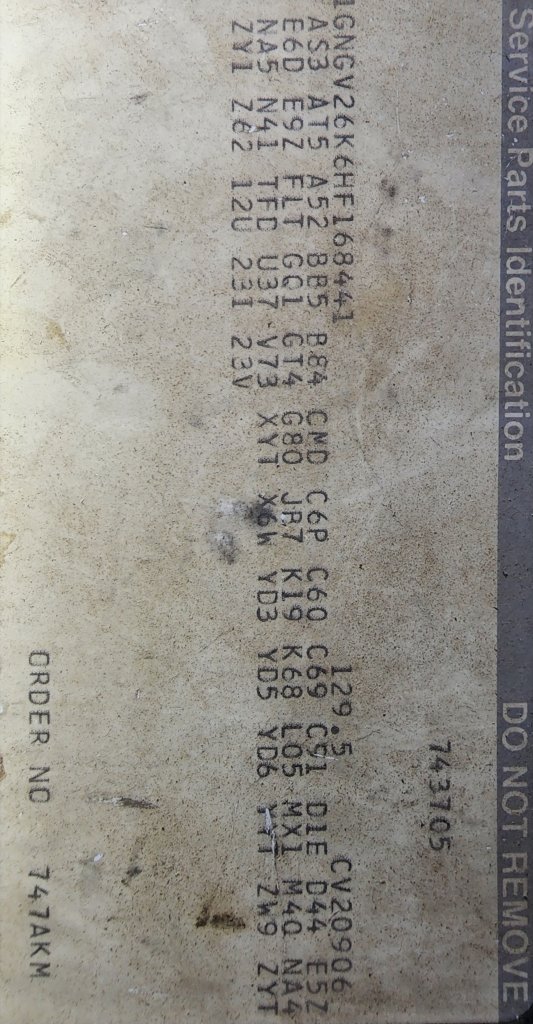

Well guys, I stand corrected. Checked the code, GT4 just like I remembered, which means 4.10, right? Wrong. 3.73's it is.
I had it in ming that GT3 was 3.73 and GT4 was 4.10, but GT4 is 3.73 and GT5 is 4.10. Guess that's what I get for thinking instead of looking...

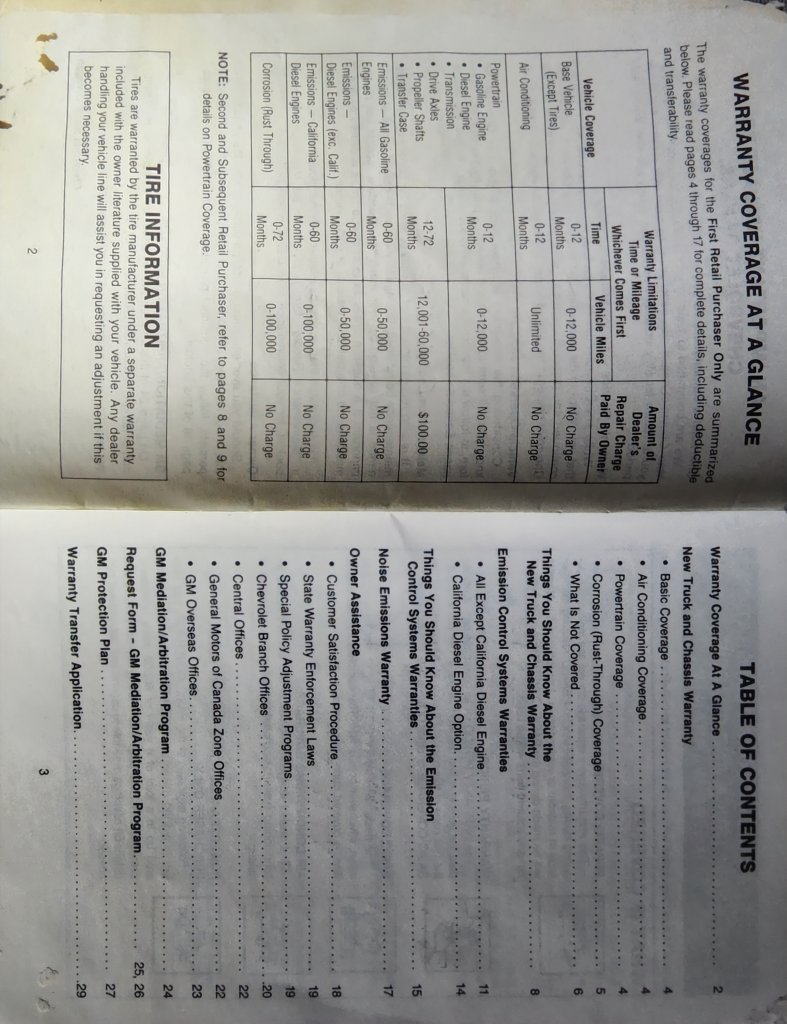

Side note, if anyone is wondering if their truck is still under warranty, I've got that manual in the glove box.
