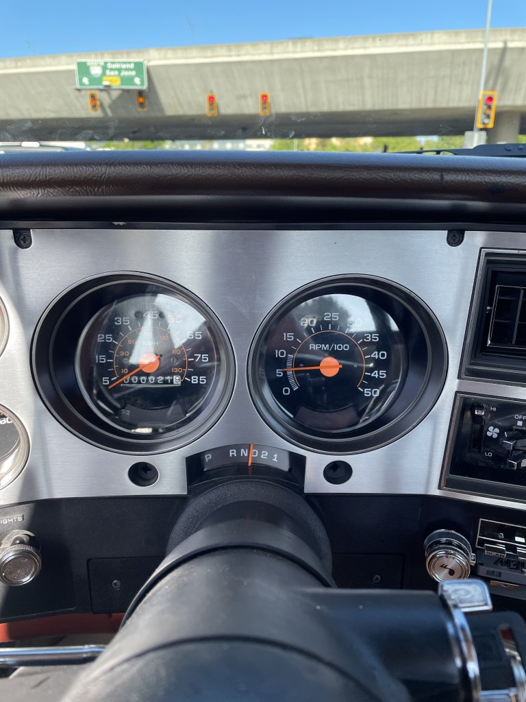

My factory tach.. yes, unique circuit bd is required. I have a spare factory tach, not sure of the value.

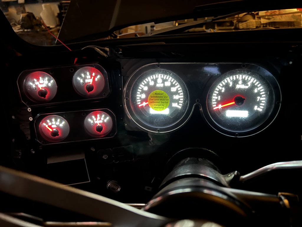

Here is a picture of the VHX series, also available with a black or carbon fiber back ground for same money. Came with all new sensors including speedo.

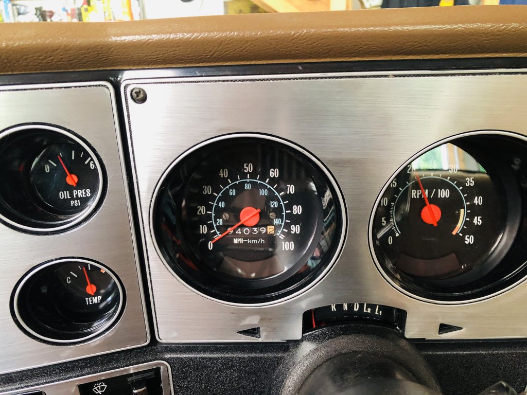

I did the full kit on my 87. My 87 is a TBI engine, Only issue I had was the tach needle was bouncing when I installed it. I replaced the ignition coil and the issue went away. The kit is expensive but worth it if you want the factory look. Im very happy with my install. It was pretty simple

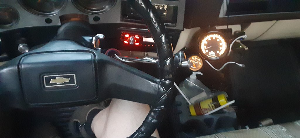

@scrap--metal So I was in the truck the other night and just happened to think about you. So I took this picture where you can really see it from my prospective. That's taken right for where my eyeballs normally are.
Thanks for the picture. Both gauges are very visible and unobstructed where you have them.
I haven't gotten around to putting my tach in yet, or testing it for that matter. I've been working on my Camaro in what little free time I've had over the last week.
