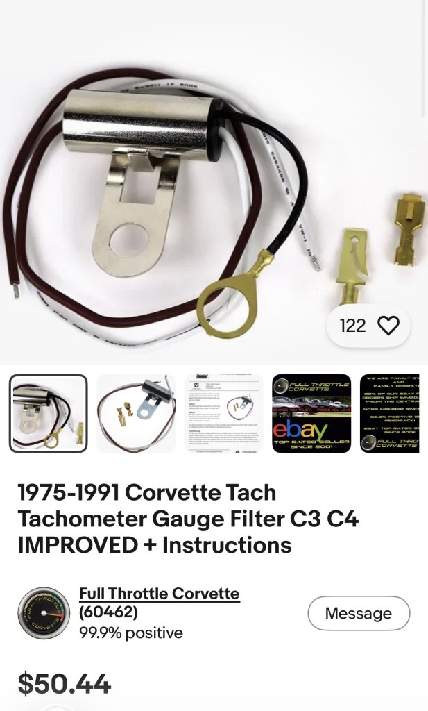

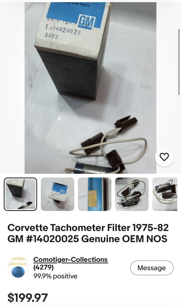

Yeah, the filter isn’t required, mine worked fine without it except for a little flutter on extremely cold starts. All it does is clean up the signal going to the tach. If you ever want to add one just wait until you come across an 80’s Firebird or Camaro being parted out and grab the filter out of it. It’s bolted to the firewall and that mount is also its ground. I’ve also seen reproductions for sale on eBay but they’re a little too proud of them IMHO. $30-$50 for about $1 worth of caps/resistors/wire in a little can just seems ridiculous. There’s someone on eBay right now trying to sell an OEM one in the box for $200. Good luck.
