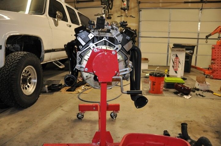

A year ago I put a 454 in my 87 v10. I tried the Summit long tube ceramic coated for $300 and the Hedman long tube ceramic coated for $800. The Summit fit better and had a nicer finish. 11 months later and they still look good.

take a looks at page two of my thread. Summit vs headman
Hedman has two basic designs of headers, besides "Elite" and regular. They have one design like yours and they also have a version that hangs low like that Summit header you have pictured. I have run both styles of Hedman, they both have their merits, but I do prefer the version you have.
