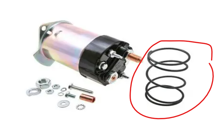

One tiny little question; the solenoid spring is installed correct?

Pricey but gives you an idea what to look for if you don't have one.
