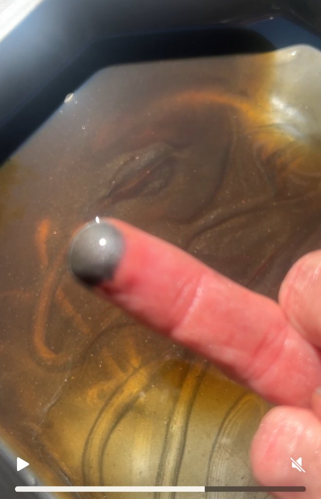

dropped the pan today and it was just filled with fine shiny sludge. And I had just put in a new trans filter and fresh ATF. The ATF is now clear to Brown. Need to figure out what caused it before I replace it or does anyone think there’s even a chance of running it again at this point?
I would post the video of it, but I’m not sure how to do that

Did you run the transmission selector lever through it's range of motion? Slime in the pan is not keeping the parking pawl engaged.

the pawl was engaging when i cycled the rod. little spring on pawl was intact and everything on the shift shaft seemed to be tight and as it should be.
there was one bolt in the valve body loose and sticking up. that’s all i noticed.
we had just changed fluid and pan gasket and now it as you see it in photo above. there had been nothing bad in pan prior to this first start.
found this short piece of cooler line on the input side that had collapsed inside. trans got really hot during 20 minute break in of engine. i’m guessing the fluid was just circulating, or barely circulating.
also had a brand new converter on it.
1. with all that metal sludge is it salvageable? should i at least try refilling and running?
2. want to understand what happened so it doesn’t happen again to a new trans if i have to go that route.

From my experience with automatics, all you can do is fill it up with fluid and see if it works. If it doesn't work - pull it out. Replacing the fluid and filter never fixes any problems. On some newer transmissions, you can pull the pan and replacing some small electrical parts to fix shifting issues, but not on the older ones. Also, the amount of metal in the pan generally doesn't have anything to do with the transmission working or not. Some work great with a ton of metal in the pan, some don't work at all with no metal in the pan. When it comes to transmissions - I have replaced many of them, fixed some, burned some up, etc. but I am no transmission expert by any means.

Are you sure the parking pawl is disengaging.Put the drive shaft back in the transmission and try to rock it clockwise counter clockwise,see if it rocks if it rocks I'd assume the parking pawl is not disengaging. If it doesn't rock, I'd assume the heat caused it to sieze something. I'd tag Nick @NickTransmissions
