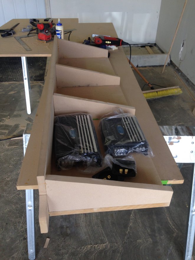

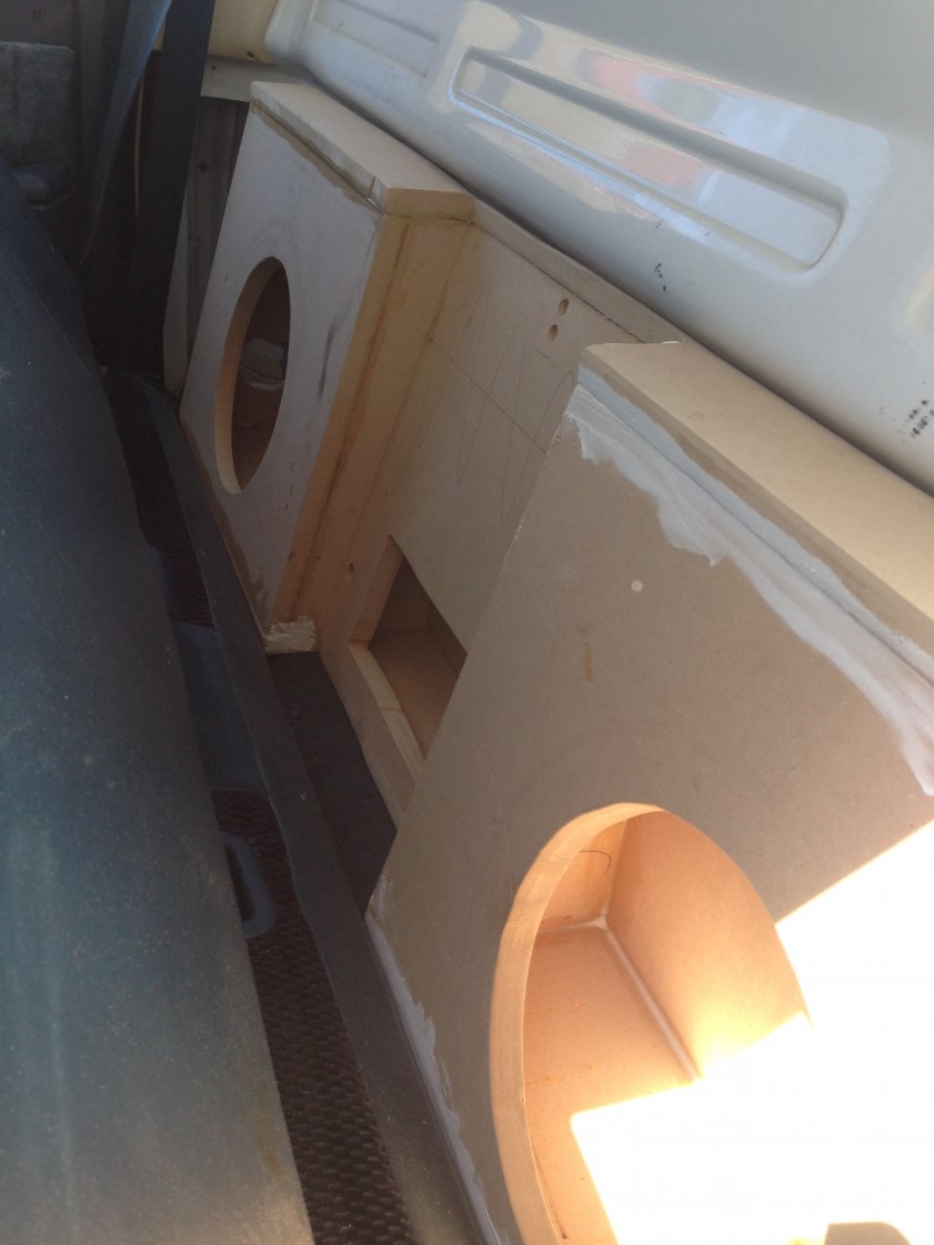

3/4" MDF $30. I used wood glue and 1 1/4" finish nails with my nail gun. You can see I put the back plate on top of the bottom plate, then I made the 3 sections. The two outside are for the subs, and the middle is for the amps and power/ground distribution block.

Its all framed up, time to cut the holes for the subwoofers (gotta make sure to make them low enough to keep the magnet from hitting the back plate) I could have mounted them about 1-2 inches higher but I really did not want the magnet to hit, I did not want to have to put in a spacer or re build the front and re-cut the hole.
I recessed the amp rack because the amps are almost 3" thick so I had to recess the rack.

I also decided to go 3/4" higher than originally planned. The curve of the back wall of the truck under the window does not allow you to make a square edge on the back plate of the box, so you have to keep it 3/4"-1" low OR you can go all the way up and shave the back end to match the curve. I chose the latter as it gives me a tiny bit more airspace and it looks really nice.

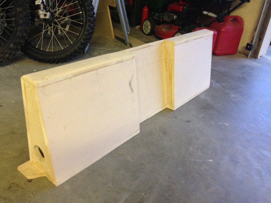

the "tabs" on each side of the bottom plate WAS going to be how I secured the box to the bottom of the floor, they are cut the way they are to make room for the rear seat mounting bracket and bolt. The box is so heavy and snug that I do not have to bolt it down.

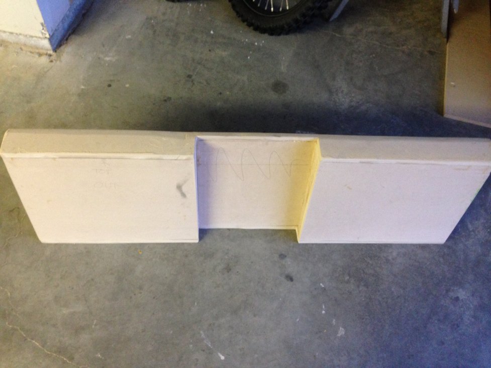

Here it is in place, I kept it here as I built the 15" x 7" 6x9 mounts.

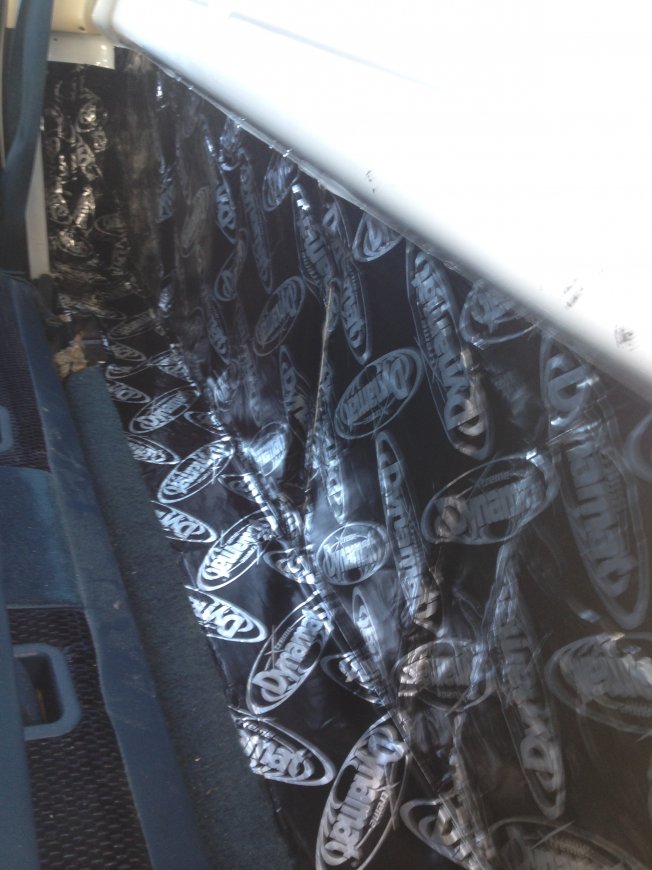

dyna mat the whole rear end

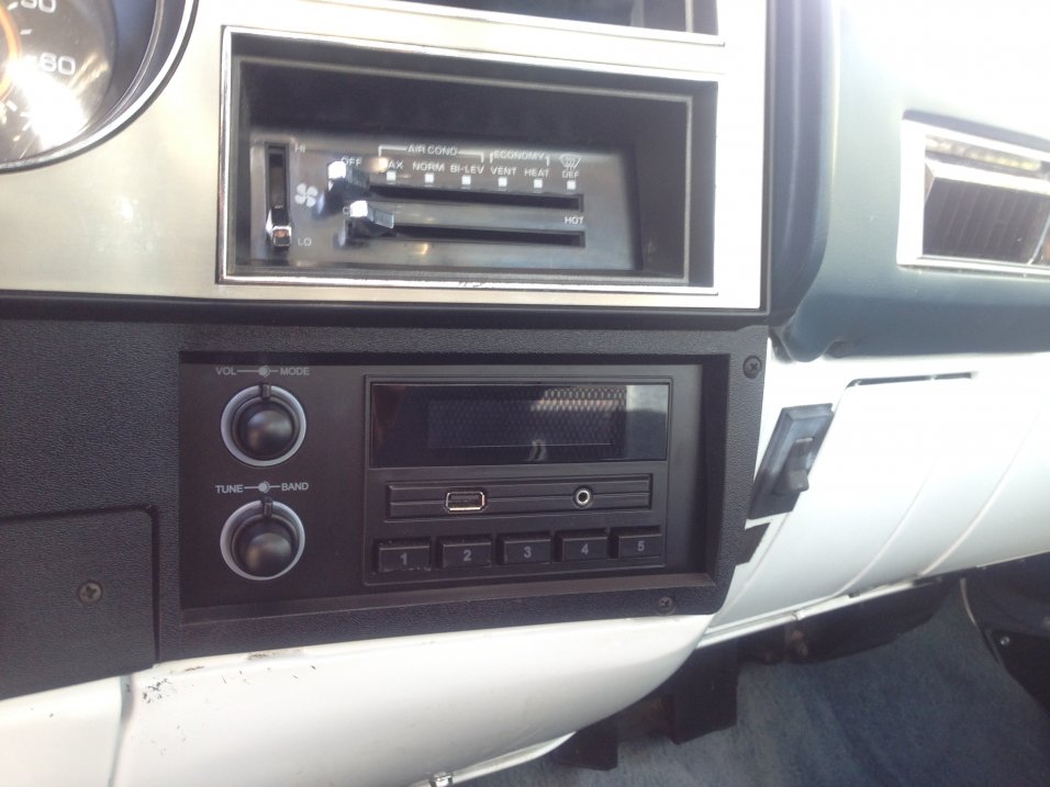

Here is the RetroSound Newport 1.5 DIN bluetooth, 2 usb's, 2 mini jacks, microphone......
simple, lets me hook up my phone through bluetooth, and I can plug my phone in the USB and charge it while I listen. Its very simple, basic, and looks true to year which I really like.

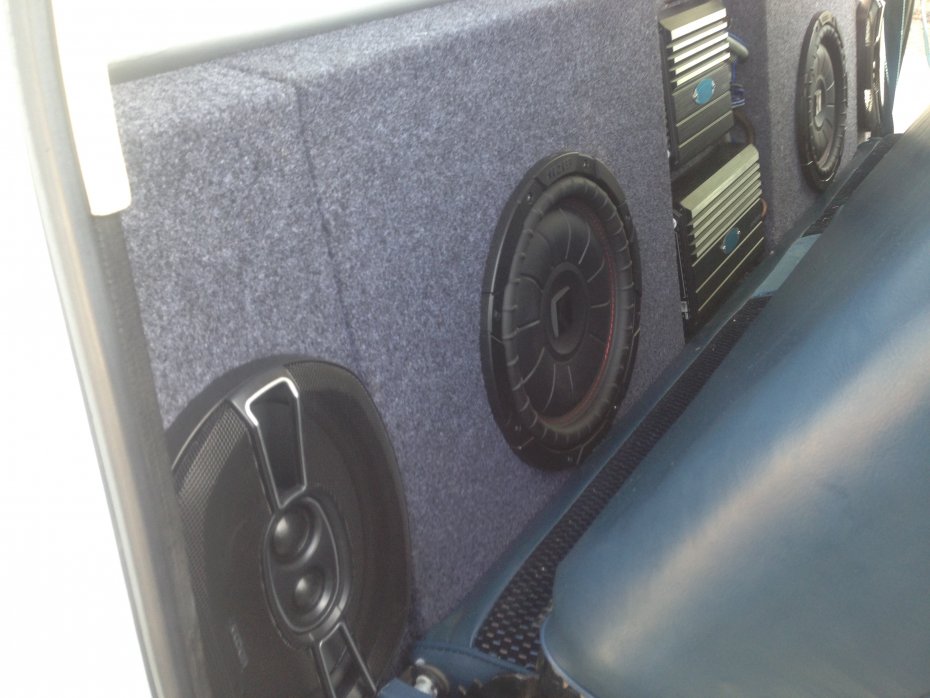

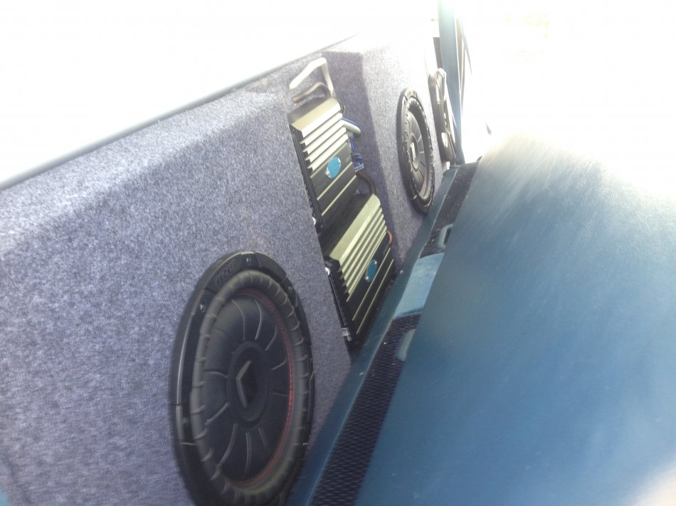

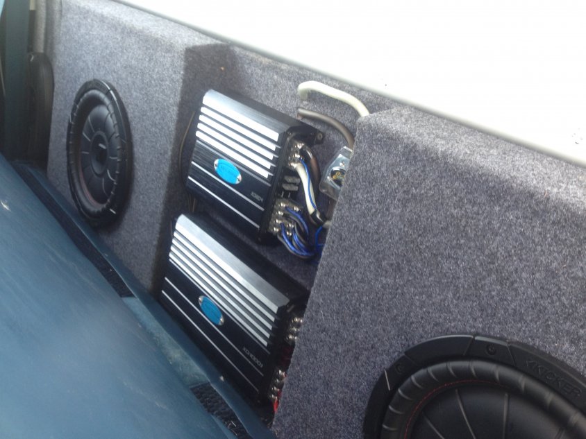

Final product.
I have a few clips I ordered that will help with the routing of the 4 gauge power and grounds, as well as the components and speaker wires to make them a little bit more neat.

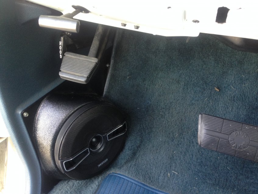

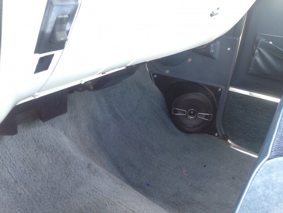

Here are the 6.5's installed in the kicker panel. I plan on completely redoing the interior, changing the color to grey/charcoal, so that is why I carpeted the box in that color. And when I do that the kick panels will be painted grey as well. The interior is in really great shape though, so my plan to do it next year may get pushed back a couple years.
