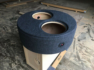

I like your box in the back. I'll be very interested to hear how you like it. I am working a similar project on my burb. I went with 3.5" Infinity Reference in the dash corners, Kenwood 4x10s in the back, and a Retrosound head unit. It sounds way better than the barely functional radio and speakers I had before but not great. I agree with most comments about the Retrosound. It's not a high end head unit, but it looks the part and sounds ok. I have had an issue that the bluetooth calling gets all garbled for the person on the other end listening to me. It only happens when the car is moving though. It's fine if I am stationary. I think it is the plugs/wires/cap on the engine that were replaced with aftermarket parts. I've read that the AC Delco parts have better insulation so I am going to swap them at some point. I am currently finishing up the LMC window relays and 100% of the weather-stripping, but I just got the Q-Form Kickpanels yesterday. I am going to be installing Infinity Reference 6.5" components this weekend in them and a Pioneer 2 channel amp. Test fitting the kickpanels last night, they appear to clear the e-brake and don't look like they will intrude too much on foot space. I need a sub for some kind of low end coverage. I don't need to shake the neighborhood, but the current setup has no low end at all. I am debating a box like yours, or a round box that fills the spare tire location. I have 33" tires right now and the spare doesn't fit so that space is wide open. This is the closest I've found to a premade box that I think would work:
But $400 bucks seems 2x what that should cost from a dude who sells random garage sell finds on ebay. Making a round box seems like a pain, your box looks like an easier fab.
$400 does seem steep for some MDF made into a circle...I have 32's on mine but I put a 31 inch spare in there because I really don't like the idea of driving around with a spare!
Mine wasn't all that difficult, just made a template with cardboard of the wheel well and trimmed it up a couple of times, made a little popout for the gas filler bump in back..my goal was to keep it flush with the well in order to still fit a 4x8 sheet in the back so it's only 5 1/2" deep internally. The led me to use a shallow mount sub as well. I decided on a sealed box so I only needed .75 cu ft of space which I calculated by filling the space with a .75 cu ft measure amount of Perlite and then put the inside baffle where it needed to be. The back part of the box that doesn't have a lid on it in the picture I was going to use for storage and put a hinged lid on it.
I'm pretty sure you could get 1.5 cu ft out of the whole box if you wanted to port it (way beyond my skill set to tune a port honestly) or I guess if you really NEEDED 2 12" subs you could increase the dimensions on the box...

I think one 12" would be enough and I would go sealed instead of ported. I like the tighter vs boomier bass anyway.

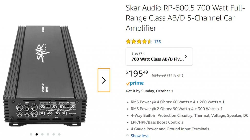

Ok...so I'm rounding up parts and I think I'm almost there but I need a 5 channel amp:
Head Unit- Pioneer dmh c2550nex- It allows for remote mounting of the touchscreen/headunit so I am going to be able to mount the unit in stock radio location and secure the touchscreen to a mount without cutting anything.
Front speakers- 4x 3.5" Cerwin Vega HED 30w RMS/275w max- 4ohm
Rear speakers- 2x 4x10" Cerwin Vega HED 50w RMS/320w max- 4ohm
Subwoofer- 12" Infinity Reference 250w RMS/1000w max- switchable 2/4ohm
I have read that you want an amp that has 75-150% of the power RMS? So if I were to run each pair of 3.5" in one channel, each 4x10 on it own channel and the sub at 2 ohm would that make it a 5 channel amp?
So would this amp work out well? Also, I sent the seats out to get reupholstered so I don't have them to check but will 23"lx7"wx3"h fit under a front bench seat?!?

I don't know anything about that brand. Nor that amp. But see how it says "class AB"?
That's not as good as "class a".
Have you got any other choices that involve a better amplifier? I'll look it up... but it might suck.
My initial thought involves wiring the 3s and the 4x10s in parallel out of the front channels and bridging the rear channels at the amp to power the sub.
Right +, left -.... and that brought concerns about that amp quality.
Y u no haz 6x9s?
Y u no run a dedicated subwoofer amp?

Tons of good reviews for that amp. Is 5 channel really? It has dedicated subwoofer channel? Pretty neat for that price. Ppl compare that brand to Rockford Fosgate?! Mmmmmmkay.

Yeah....I was trying to go simple and now I'm down the rabbit hole! I just wanted to drop in the 4x10's to the stock location and be done but running 6x9's in those spots with a spacer probably the way to go...like you said in the beginning, haha
I thought about 2 amps as well before I found the other one..I think I will give that amp I found a shot!
