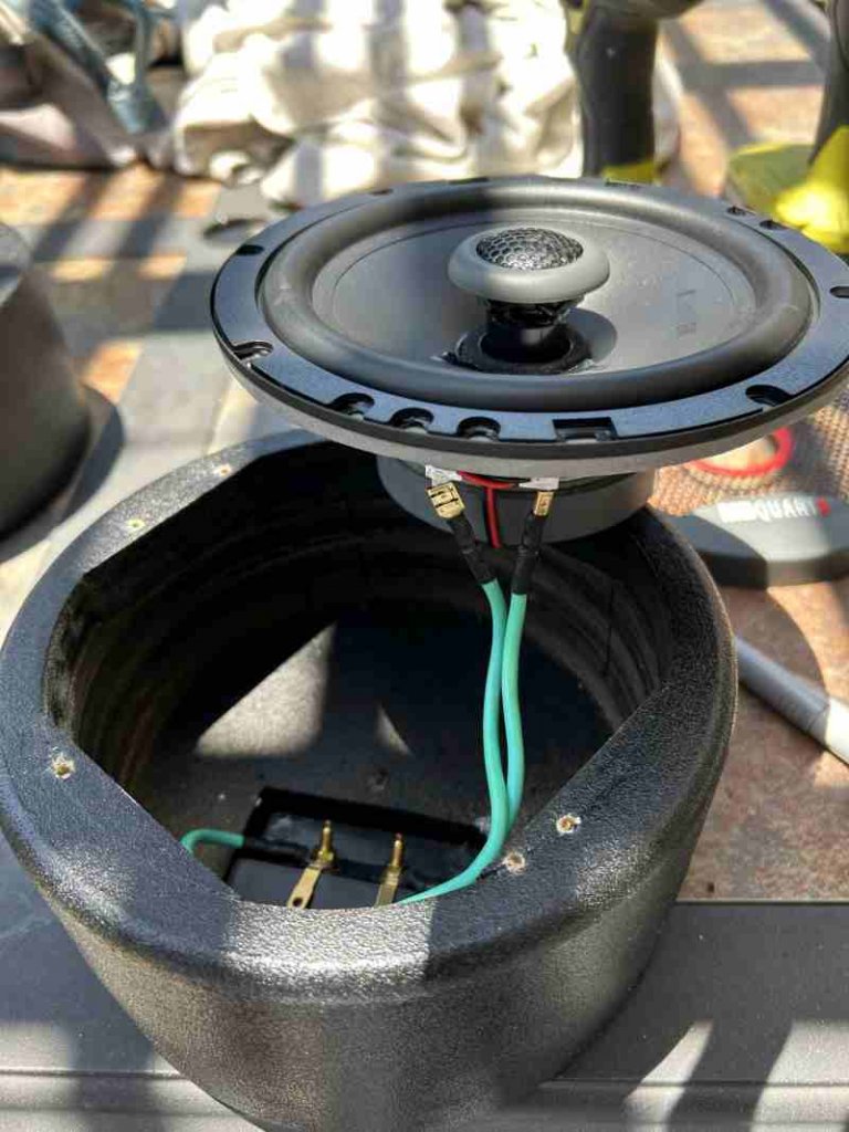

The speakers came with spade connector leads but the wire was 22ga at best. In trying to figure out a way to use the full gauge of the speaker wire all the way to the speaker, I was able to also compensate for my inability to solder very well. I used some solder/seal fitting with new copper spade connectors..run a heat gun on them and they solder and seal. I just had to be careful to not let the solder get into the spade connectors!

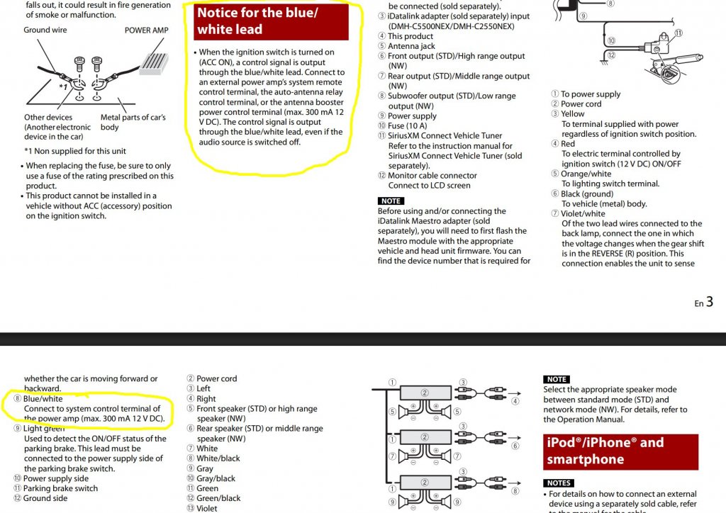

Hopefully this isn't too dumb of a question but I'm going to hook up the head unit and I had a question on the ACC position and the blue/white amp trigger wire.
From what I can tell, the power supply from the head unit doesn't have an "in" from the ACC wire but has an out to the amp that is allegedly triggered by the ACC position on the switch? From what I can tell there is only an in from the ON position (red) and the constant power (yellow)?
Or it looks like the red should connect to ACC?

Red goes to switched power, yellow to constant power (either from the fuse block or cigarette lighter) for clock and preset station memory.
The blue/white is only for when you have additional amp/amps.
It is only hot when the stereo is turned on, to switch the amps on.
MUCH APPRECIATED!

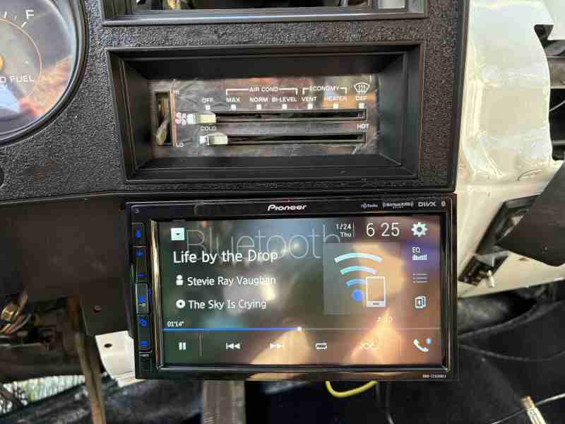

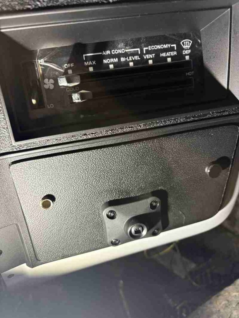

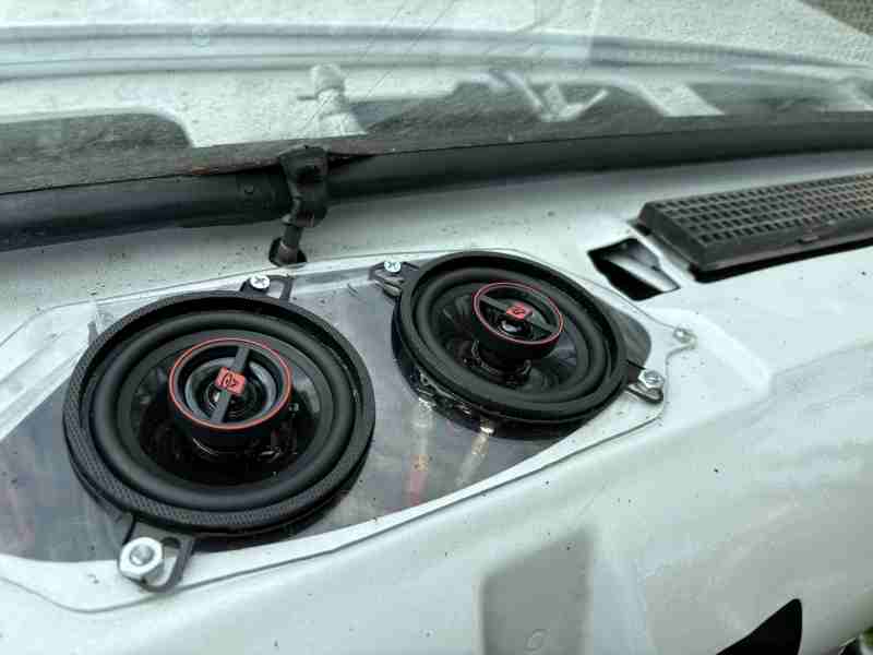

Alrighty...got everything hooked up and I'm impressed with the Cerwin Vega HEDs..I have (2) 3.5's in the dash center spot and (2) other in the stock locations with stock location 4x10s hit pretty good! I did supplement the rear speakers with some MB Quart 6.5" pods that I am going to attach in the back by the A/C but the CVs sound fuller..thanks to everyone for the input and guidance!

very nice job with the radio adapter plate/cover

Wow! Great work! I like the big screen install! Wanted to do that on the 86 but for as little as it gets driven, couldn’t cough up the $ for it to collect dust 300 days a year. Wondered how it would look and after seeing yours would totally do that in the future.
One thing, on your center dash speakers, make sure they don’t protrude too far for the dash pad to fit properly.
Mine and others aftermarket 3.5” dash corner speakers needed to be mounted under the dash frame and mine still force the dash pad up slightly.
I did not like installing the new dash pad. I would really have not liked having to remove it again immediately!

Came across this kicker setup for the dash. Was curious if anyone has used em and has some feedback on how they are?!
9,559
17,538
What are they rated for? I like the individual 3.5kickers in the dash (with an amp). Iirc they’re 55-60W rms. They’re loud and clear but horrible bass response (as imagined). I have a lot of the low frequencies tuned out. They’re more like a glorified tweeter with some midrange and the 4x10s and the sub do the low end work.
