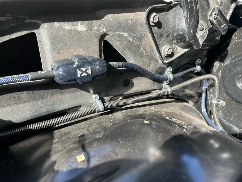

@scenic760 I can’t find the box. Easton is not around. i would say his amp was 12” long 6” wide and 2” high and fit great under seat. I fabricated some aluminum mounts that I screwed to floor so amp would have air circulation around it, not sure that makes any difference but it looked cool…
let me know if you need anything else

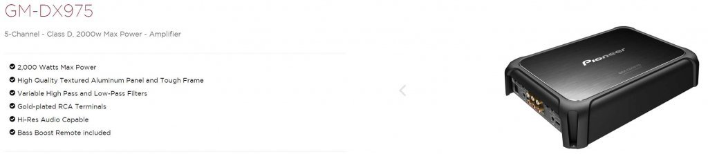

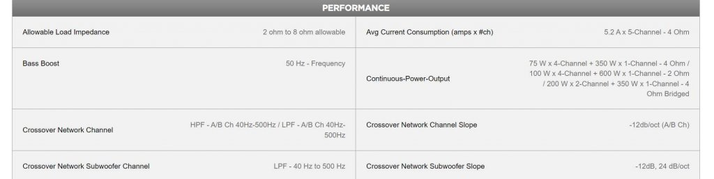

I picked up this amp as it looked like the best fit for my sitch..

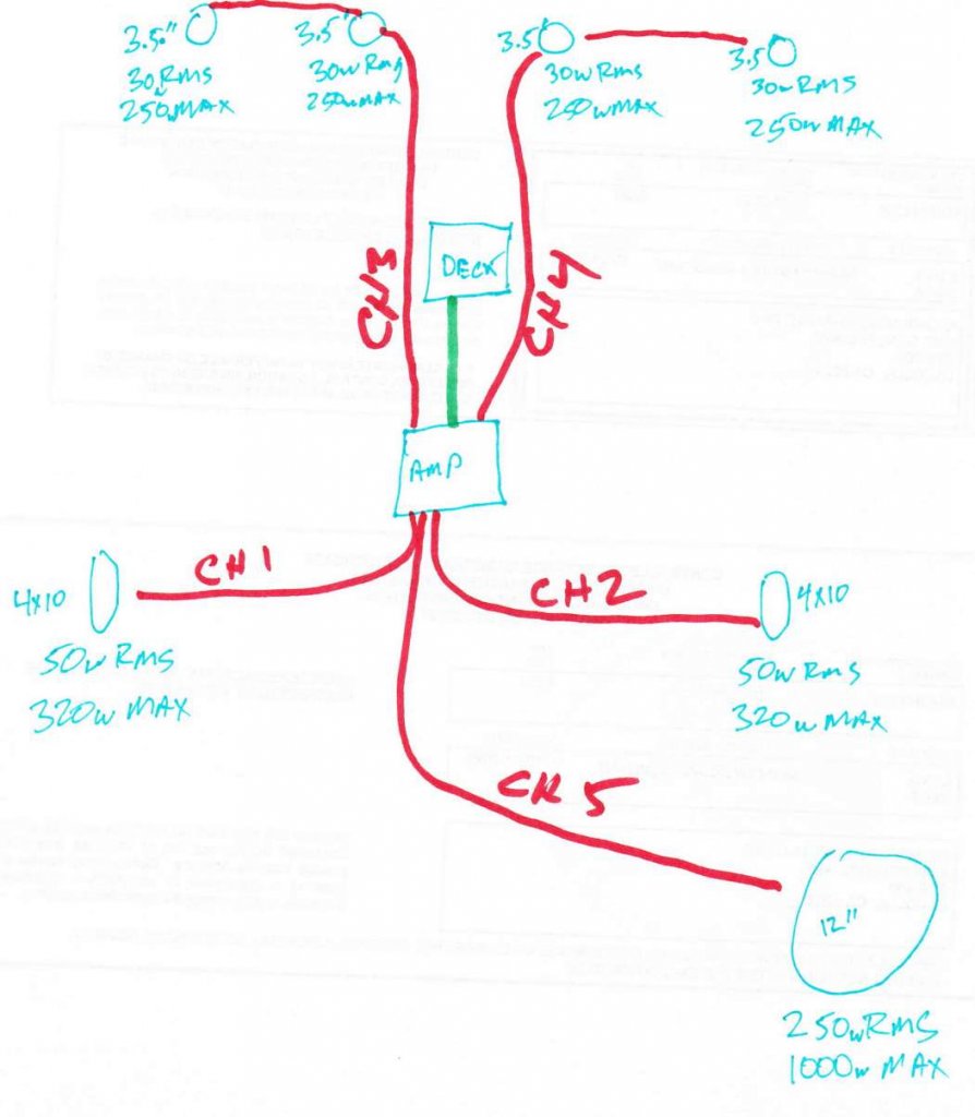

Another technical question....I'm assuming as long as I hook up speakers between 2-8 ohms the amp will automatically "see" the correct impedance and adjust current accordingly?
I guess the reason I ask is because my plan is to hookup the 4 front 3.5" speakers in parallel, 2 on each channel, which would produce about 2 ohms (?) Each speaker would receive 50w?
On the back, each speaker on its own channel would be 4 ohms so 75w each and then the sub at 2ohms would get 600w?
I could also select 4 ohm for the sub if that's too much wattage on 250RMS but I heard a sealed box needs a little more power to function properly?
Does the amp care if the impedance is different on each channel?

Looking at this, one is left to assume that 4 ohm amp power is your only choice out of channel 5 - and there is nothing wrong with that. Especially with a single voice coil 4 ohm woofer - that's likely your best bet.
Again I know very little about that amp, like how the power to channel 5 is sourced.
I know it comes with a "Bass Boost" knob , which is likely an independent gain for channel 5, however.
I don't forsee anything wrong with your plan. Parallel wiring in this instance reduces the resistance of the speakers- not increase the output of the amp when wired +to+ and -to-.
The result is the working temp of the speakers will increase, the distortion level of the speakers increases, the volume of the speakers will increase, and that is done at THEIR expense to spare the amplifier from having to output more power and increase ITS' working temp and distortion.
The 3 inch speakers will see a 2.5 or 2.6 ohm load I think. There is a formula.
If your speakers are good it won't blow them up by separating the voice coils from the magnet. Those Cerwin Vegas are by no means a competition grade unit and I imagine short trips at a moderate volume won't hurt them.
Only one way to find out short of contacting Cerwin Vega.
Again, your due diligence or lack of is not my problem. I'm a stranger on the other side of the internet.
In all things, including car audio, you get what you pay for and the sky is the limit.
Those speakers and amp are low budget and I expect a similar level of performance. Granted to a guy like you that appears to be shooting from the hip and likely doesn't claim to be an audiophile persay, you may not know any difference between Cerwin Vegas or something extremely high-end LIKE Boston Acoustics or similar.. It's not a competition grade system by any means BUT! You will probably love the crap out of it and think it sounds awesome. At the end of the day you'll still have money in your pocket and every trip to work,home,or to the store will put a big shi*-eating grin on your face and you prolly ain't never had it that good.
Resistance in parallel with only 2 resistors/loads = R1 X R2/R1 + R2. 16/8 =2, so yes 2 ohms.

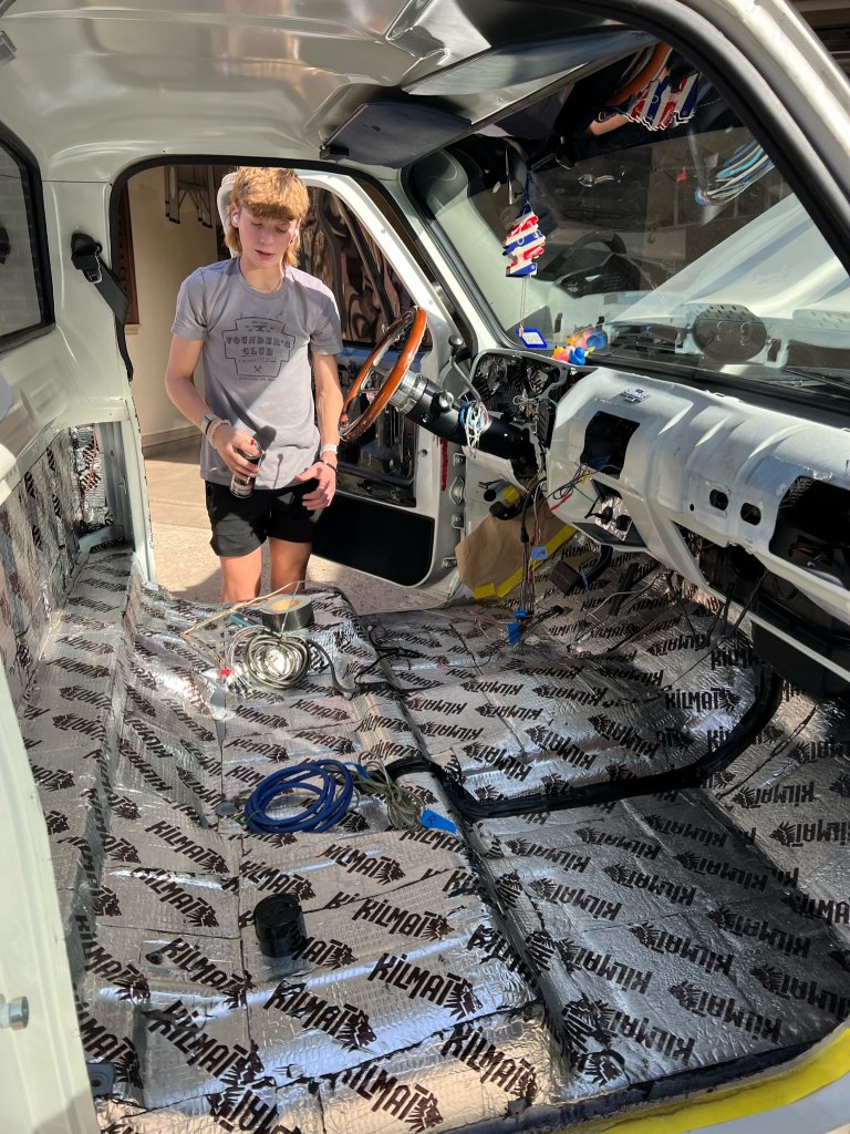

Well @scenic760 , @Rusty Nail and @Scribbles have a ton more background than me and my kid combined. I will just say that E has about 1K in the system and you can hear him turning into the neighborhood and he loves it…Kids!
sounds like you have a great plan! I will say of all the things we did with his truck, we are most proud of the sound system as I had never done anything like this before with the direct wire off battery and the fuse and big amp, challenging but absolutely cool once we finished. Not professional, but he loves it.

That's a clean install I think! One of things that gets underestimated is the knowledge you gain from doing something like that yourself from the ground up...something he can do with his kids someday! Priceless
