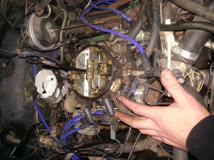

I forgot....did you check timing already? And, how does it run with the choke on? Pinging can also be a lean condition, caused by the carb, or a vacuum leak.....Oh ****...hold on. You have a computer if thats a California truck. take a pic of your carburetor, and post it up?

Trying to figure out how to attach it and it runs okay after it runs for about a min then if u drive it for twenty thirty minutes it rums so bad pings makes all kinds weird noices give it gas sputters
Send it to me...

Ok, got it. this is a little bit of a game changer. first thing I want you to do, is locate the 4 pin plug coming off the distributor, and make sure its plugged in. That same connector has to be unplugged to set base timing, which is 6* BTDC. Do that, then we will check the egr solenoid and valve operation.

also, does the carb make a ticking noise with the key on?

Ok, good. lets confirm the timing when you get a chance, with the 4wire dist plug un plugged.
