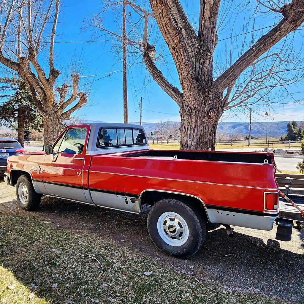

My truck was pretty badly oxidized. I used polish and then went over it with McGuire wax I used the Milwaukee buffer and then I used a polish pad pretty good.
Same colors as my sons 85 10,
I think his will end up looking as good as yours does. That red and gray/silver looks good
