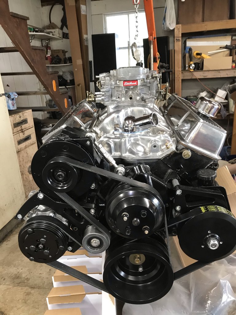

I looked around and didn't find the answer I was looking for. I want to put a Serpentine belt system on my 383. What brackets can I use? Will V6 brackets work? What would be the best years I need to look for in a salvage yard? If anyone has pics would help.
March makes reasonably priced kits for any configuration

Just a heads up the 96 and up Vortec style a/c bracket will interfere with taller valve covers. Could trim it down if you don't have a/c though
35,111
43,671
Yep. Most people notch the bracket and you can still run AC, but one mounting bolt is omitted.
Without AC, you can lop off the entire upper section of the bracket.

My expensive GM serpentine belt kit with AC compressor on passengers' side has tall valve covers because I am using old Crane gold roller rockers.
I did have to clock the alternator and will not be using the brace unless I can refigure it.
Do you have a pic of this set up with the belt and all accessories on?

No sir, that car is still in surgery. But, it's actually a factory belt routing for a non-AC truck. That's a factory idler pulley in a factory mounting location. Literally the only thing I did was cut off the upper portion of the bracket and blend the edges. The aftermarket "AC delete" pulley mount is really a useless product, but they sell because folks don't realize there's a factory idler provision.

I am using all the brackets from a '97 TBI suburban in my CUCV. Hoping to have the powertrain mounted in the frame over the next couple weekends. Any chance you know the delco part numbers for the idler and belt?

I believe I have them written down somewhere, but I'm not home. The pulley is fairly easy to match up, GM used it for a bunch of applications. The hard part is the special shoulder bolt that retains it. I've not found those in the parts stores so I've always just collected a few from the junkyard, as needed. Like the pulley, that bolt was used on other GM applications, including front drive cars.
