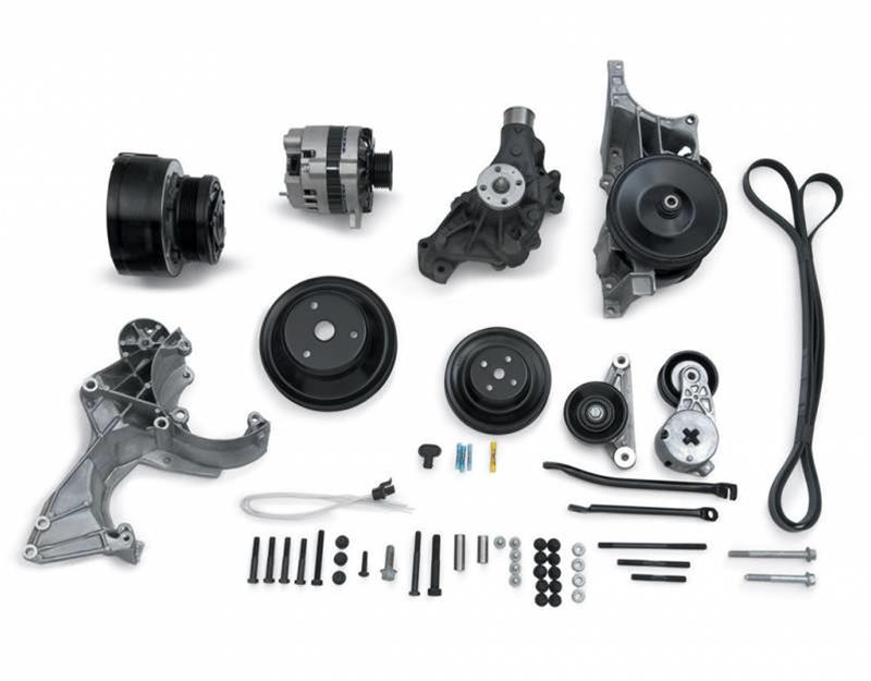

This is a pic of a new GM serpentine kit from Summit. It matches a stock kit but I am not sure which.
Would you happen to have the PN for this? Looks like my brackets and I have no idea where to start. :hat:
That's an '88+ F-body and B-body setup. Similar to the truck setup (including S10 and Astro 4.3L) but is wider set to provide hood clearance in cars and also intake clearance on the TPI F-body.
Way overpriced. :( It does include everything shown including power steering pump.
It sure is smooth running though.
