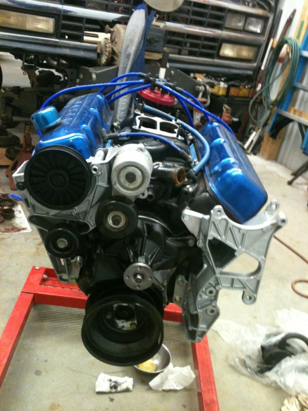

I don’t know about the a/c compressor fitment but Kwik Performance makes adapter plates to use SBC serpentine brackets on a BBC. Everything ends up nice and tight and your existing alternator and put/s pump should bolt right on.
