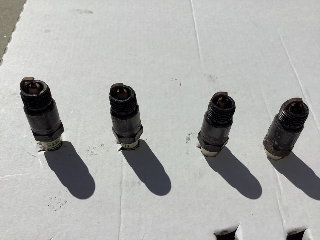

Hi guys.
After a $1800 tow bill got my truck home I want to start a diagnosis.
1989 K5 with stock 350 TBI /700R4 ( my dad says the engine isn’t original, but a “target replacement”?)
Oil is full, coolant level is full.
oil and filter changed prior to trip.
Driving approximately 65 mph in overdrive 3.73 31” tires
i heard a ticking sound that I thought was an exhaust leak. The noise quickly became a louder more metallic sound. The engine stopped, lost all power.
attempted to restart and it acts like the batter is dead. New battery and jumpstart do nothing. I can hear the starter motor engage. Removed the flex plate cover and can visually see the starter motor engage the flexplate but won’t spin.
I pulled all the plugs and tried spinning the motor with an 18” breaker bar on the crank pulley and I cannot move it.
Is my next step to drop the oil pan? Or am I just looking at getting a rebuild?
