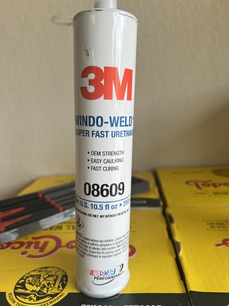

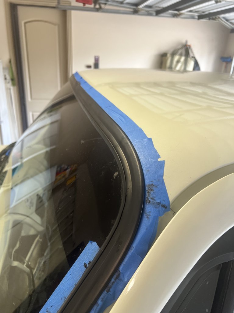

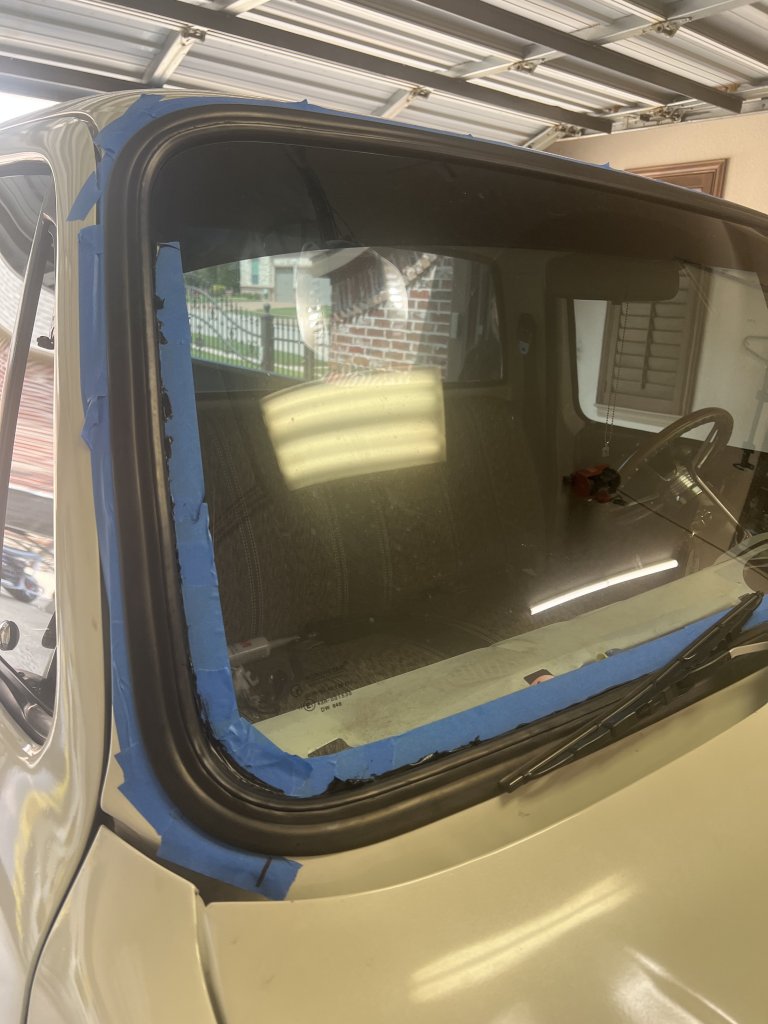

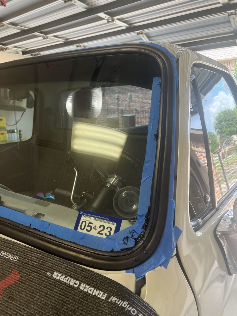

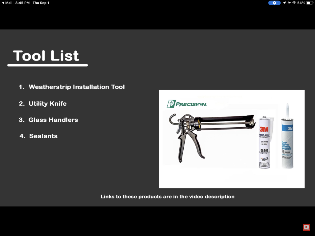

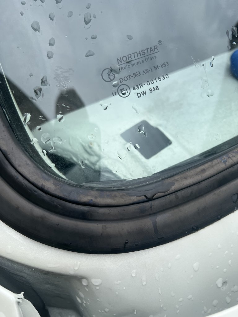

We have Been having a lot of rain in Texas lately (not complaining) but we found a leak we thought we had fixed with new Precision gaskets all around. In reaching out to Jeff Gau at Precision today he said I need to add sealant between glass and seal. He sent video, and it went as far as sealing the gasket to the pinch weld of the frame first? This was the first time I ever hear this, and not sure if that would have made of windshield glass installation any easier( it was not!) anyway, The video suggests 3M window weld. Anyone have luck with this after install? This is where it leaks, not bad but very annoying.
Thanks
Randy and E

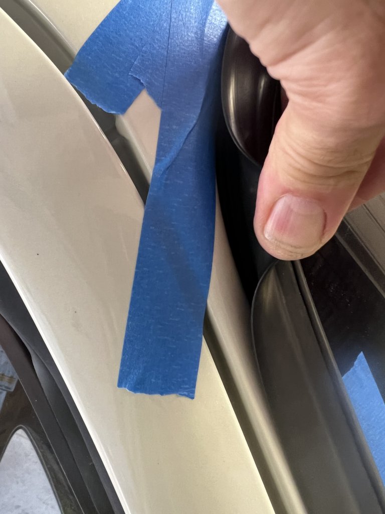

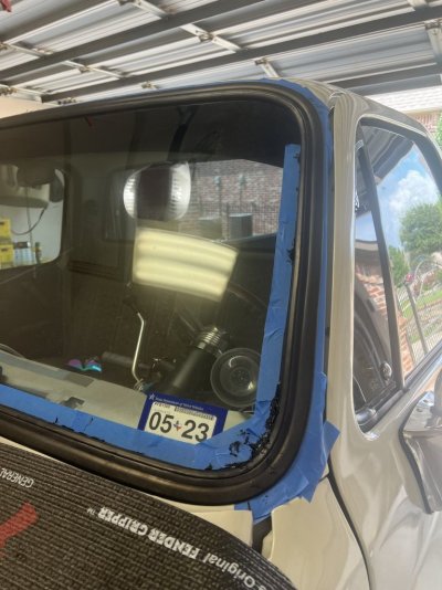

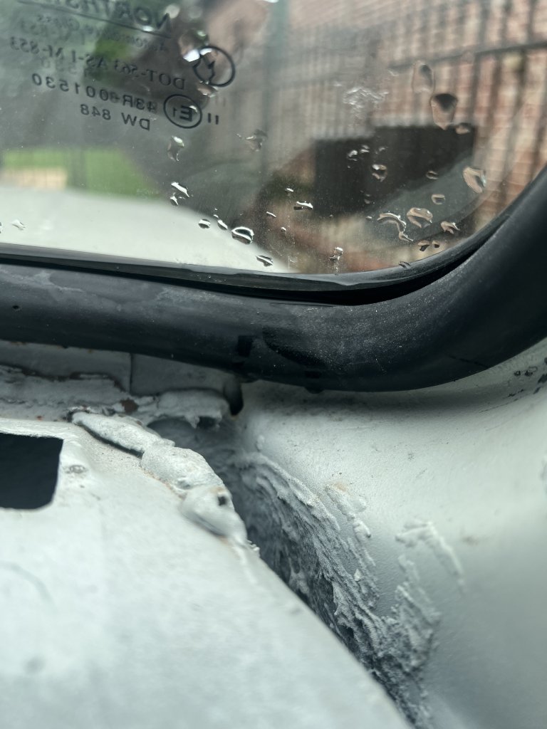

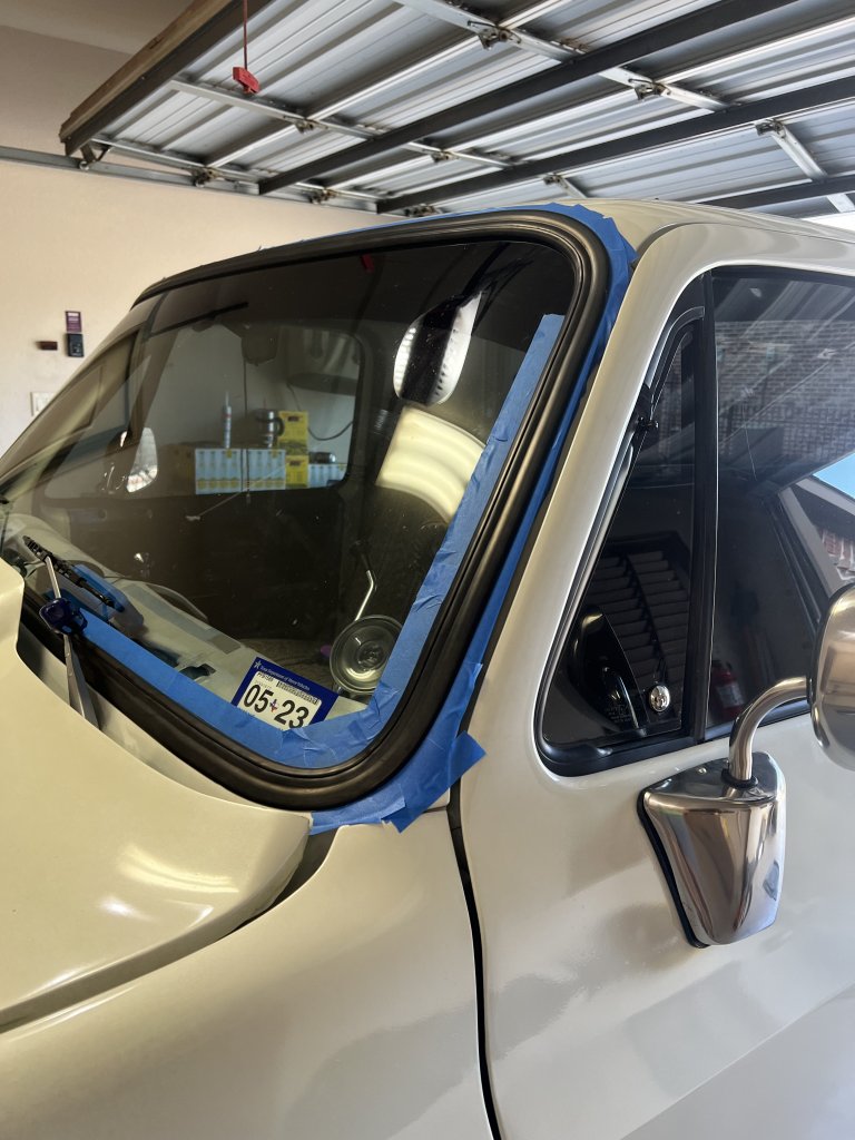

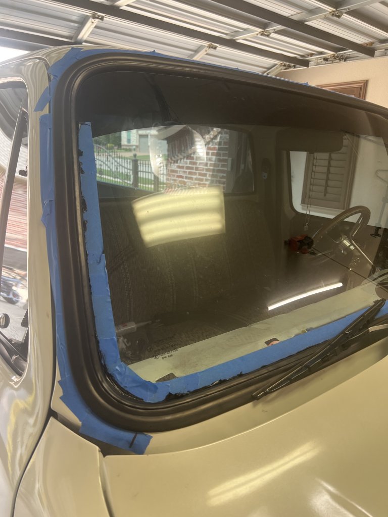

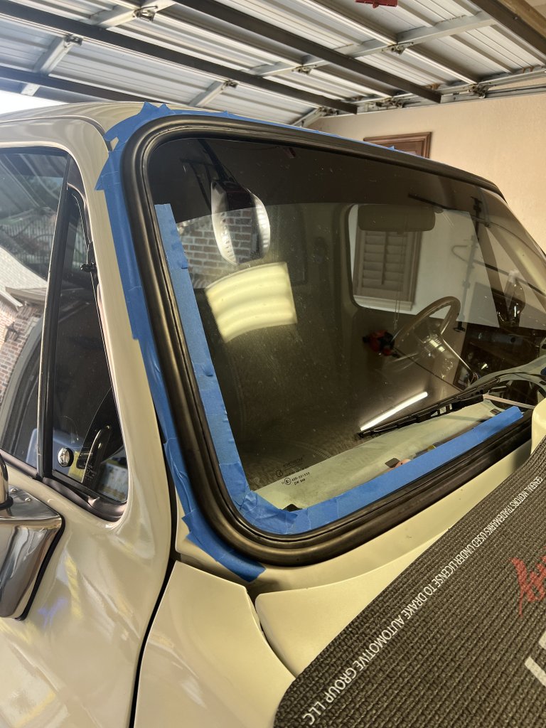

Well, we did not want to pull the windshield, it was a pain to put in so we just taped everything off and used the 3M 08608 Windshield weld. We will have to wait and see if it solved our problem. Did a line between outside rubber gasket and glass and then on the cab frame side down to corners making sure to leave drain holes open.
Precision recommends using 3M 08509 Bedding and Glazing compound on pinch weld and then attaching gasket. Then the 08608 between the glass and the gasket. We will let you know if we got the leak this time.

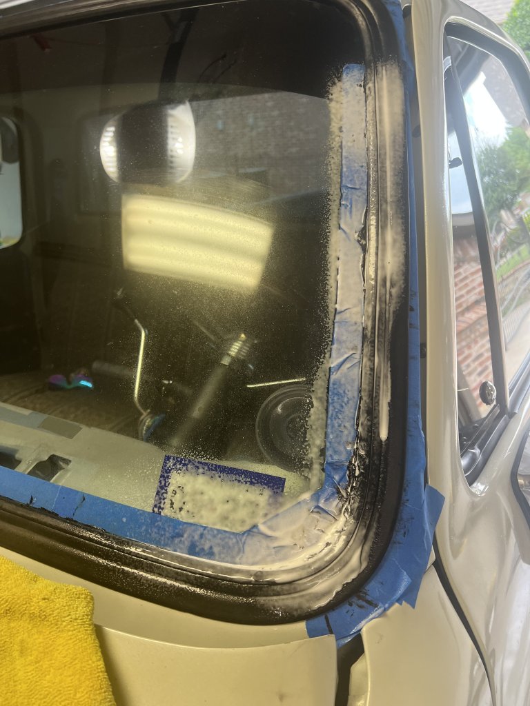

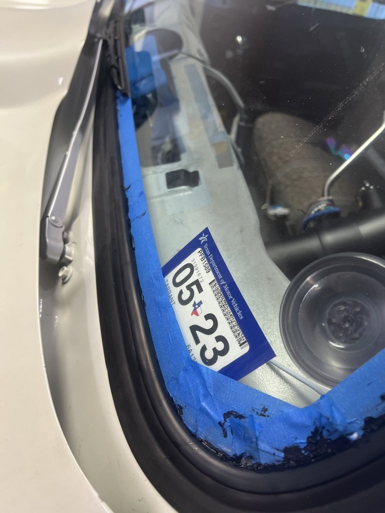

It’s a bit messy but cleans up with adhesive remover and window cleaner. Wear and change gloves often.

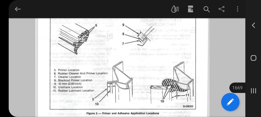

the service manual shows urethane on the pinch weld before gasket is installed. and on the gasket where the glass sits. some sort of primer goes on the pinch weld and glass before contact with the urethane.
