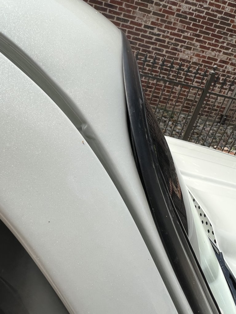

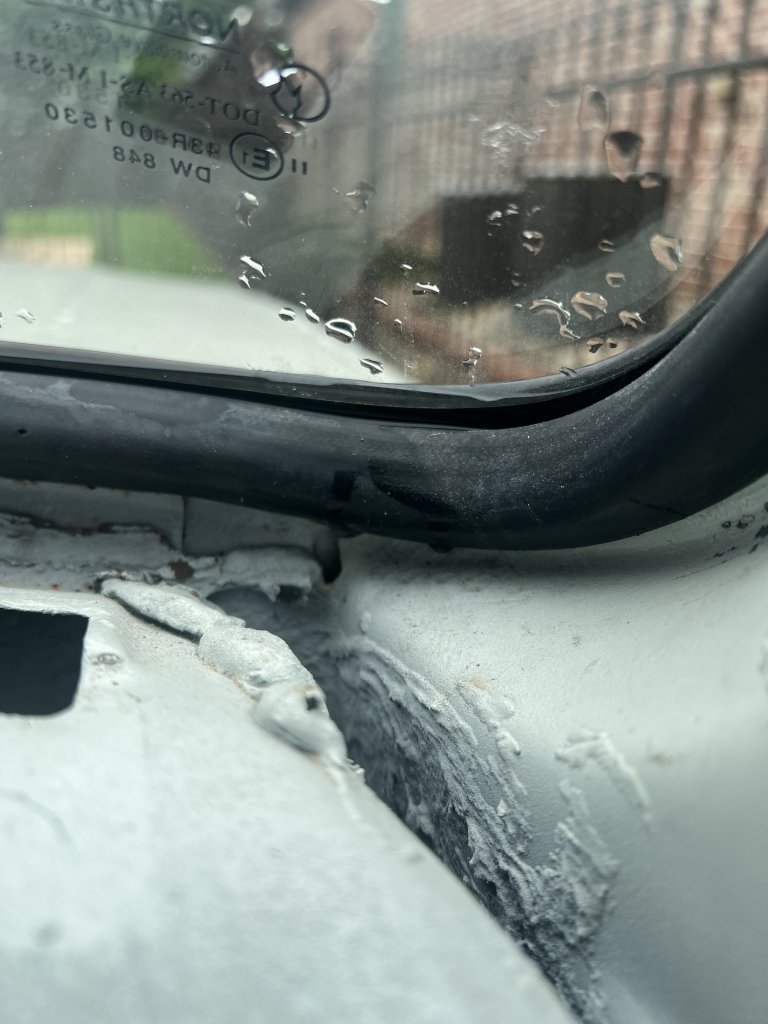

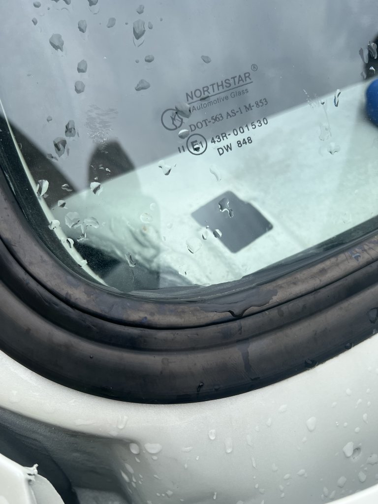

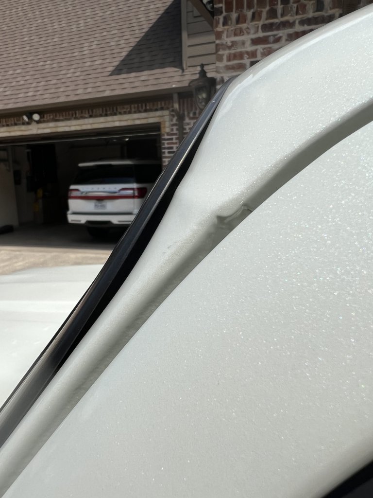

We had no rust, drains clear but the gasket itself on lower passenger side would leak from the actual seal. We used a Precision one piece self sealing gasket (no trim piece) . Jeff Gau at Precision said the sealant on the pinch weld and sealing glass into gasket was standard GM practice so Precision continued with the practice. We did not remove glass, just sealed inside the gasket around the base of the glass. No rain in forecast so we will try a hand held leak test to see if we got it. Was not hard, pulled back gasket and ran bead along base of glass and let gasket go back. Because of the large gap we had from body to upper exterior gasket we sealed that as well making sure drains remained clear.
