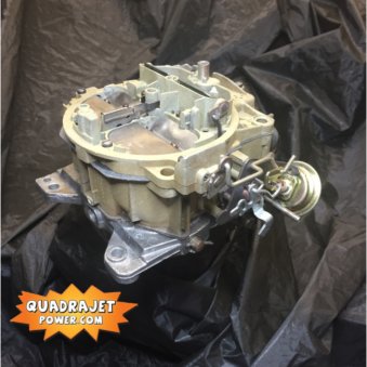

Is you choke similar to this?
Is it connected to the choke coil thermostat mounted in the intake?
Make sure the upper choke flap is all the way open when engine is warm, or if choke isnt connected.
I agree with others. You have condensation dripping from exhaust.

yeah my carb is similar to that one and choke is hooked up and is open when warm. Forgot to check if the choke was shut when it was cold.
