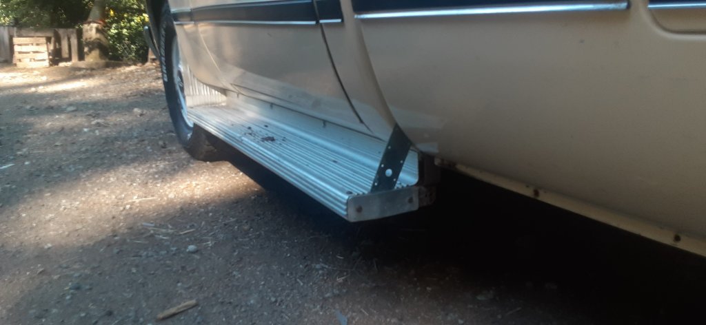

Well I've been having a little trouble with the running boards. The back part of the running board closest to the bed is great to step up on to make it easier to reach deep into my tool box. However that part of the running board is connected to the back of the cab in such a way that flexes quite a bit. I figured it wouldn't be a problem until Thursday when I noticed that I'd bent the passenger side down an inch or so. Honestly it would probably be fine for 150lb guy but my 250+ moving around is a little much apparently. So this morning I added some bracing.
Below: The L part of the bracket is the original. The part attached to the truck is bent 90 degrees towards the front of the truck and butt bolted to running board bracket. That's the problem, where it turns and goes forward makes a week spot. For now I removed the aluminum trim pieces on the end, cut and bolted these pieces of metal I had in my scrap bin on. I bolted it to all pre-existing holes so if I decided to do something different in the future I can.
There is an aluminum trim trim piece I had to remove for the brace to go in. The brace does make it very strong so it is definitely doing it's job. I'll leave it like this for few weeks and see if it creates any trouble and if the looks bother me. If I decide to keep it I will probably weld the brace to the running board, so I can remove the bolt and put the trim over it. I actually think it would look just fine like that.
Below: To me, from the front angle it almost looks like it was meant to be there.

That looks pretty good. I bet that's a lot stronger.
I'm 230-240, and hoped on it pretty good once, and it seemed fine. I never noticed that before, but then again I really didnt use it much. Sorry bout that.
Bracket looks solid though.

Maybe if you made it kinda this shape, out of some flat stock, it might look the part like a factory peice and be even stronger.

It is rock solid up front and in the middle where the under bar is where you'd step to get in the truck. It was only at the very back that it was an issue. And for whatever reason the passenger side more flexible under foot and is the side I bent a little. Was no big deal to take the bend out with floor jack BTW.
I agree. But I don't have anything on hand to do that with and I might end up doing that if I'm unhappy with the looks of the little braces I just made.

I did this on the driver side this morning. I didn't weld the bracket on I just put the trim piece over the hole thing to see how it would look. For now at least I think this will work.
