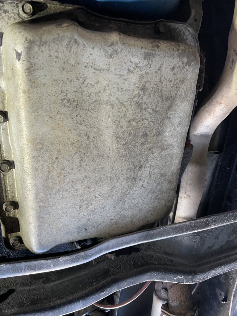

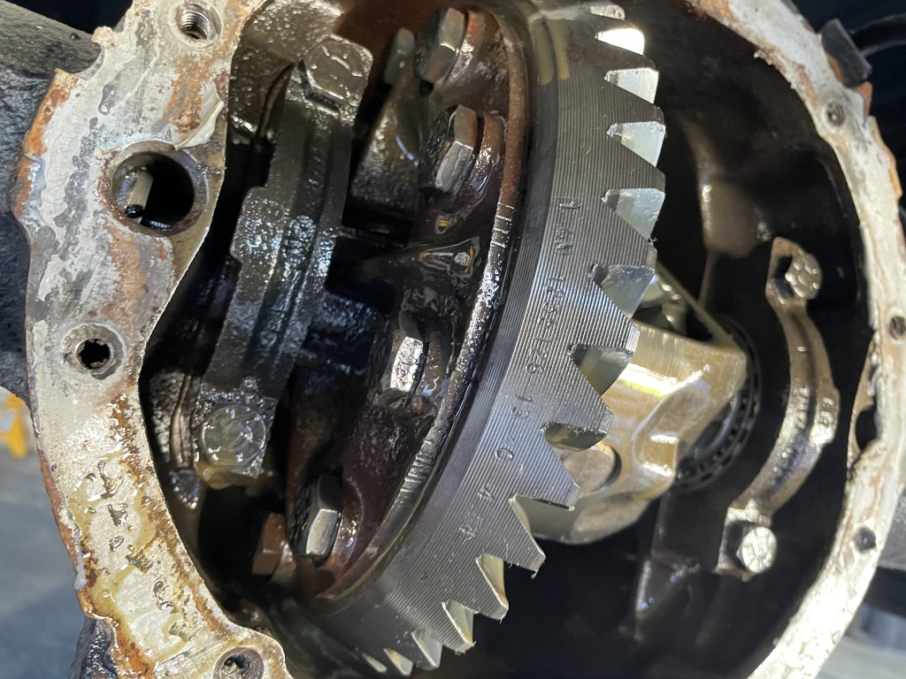

It’s counted. 3.08. 13/40 so must be the tach being off. It’s some noodle express rain forest junk. Confirmed 700R4, 60mph and 3.08s in 4th gear at cruise.

Pull the diff cover and look. It needs a fluid change anyway.
