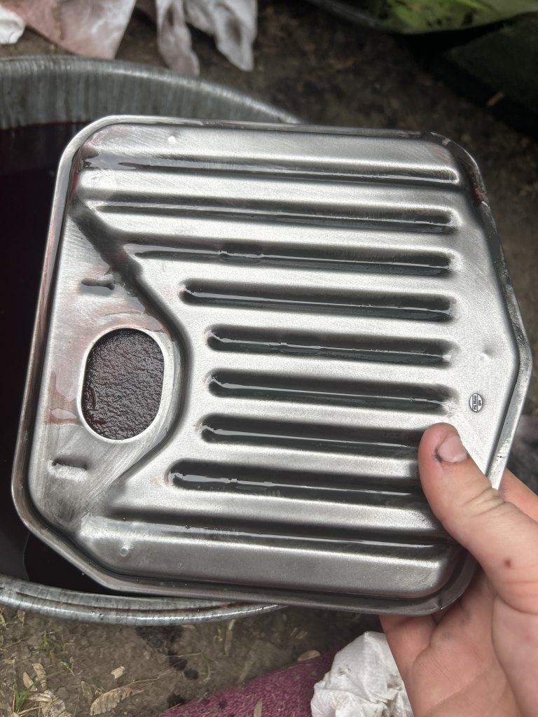

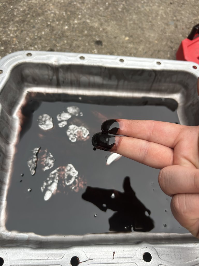

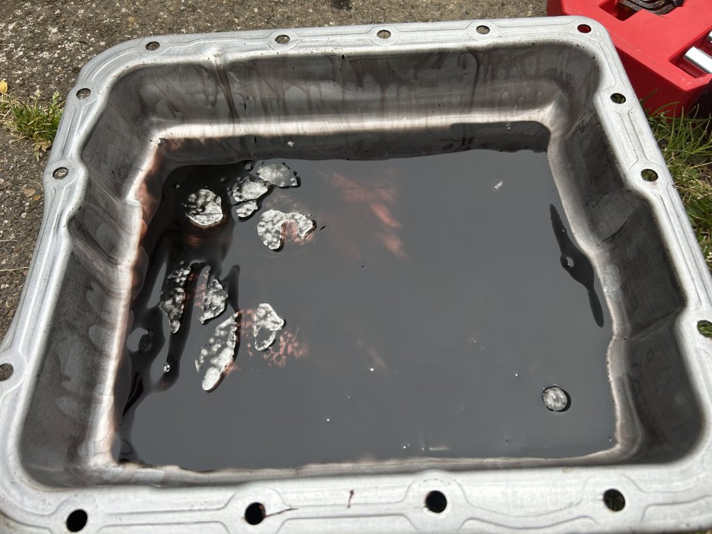

Thank you all for your help. I was finally able to drop the oil pan and there is definitely black sludge in it but no metal shavings. Keep in mind this probably hasn’t been changed in 10 years.
And yes…. It was a disgusting mess i made getting it off… and also smells awful (burnt/old smell)

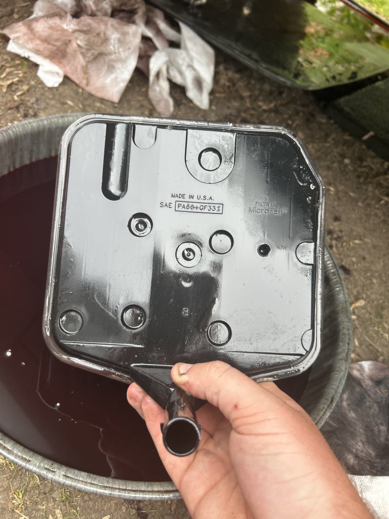

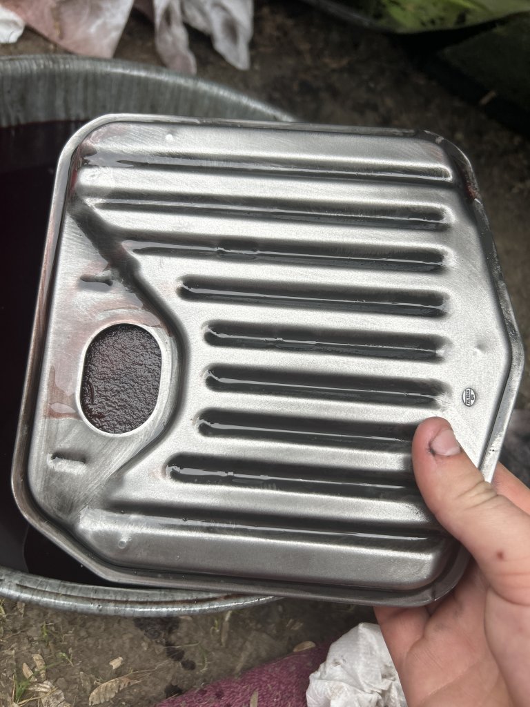

Filter too

Yank it for overhaul. Install 97+ 4L60E bonded pistons and corresponding ret spring assy in the forward drum. Ensure the pump is vacuum tested, particularly the pressure regulator valve.
Let us know what you find once it's torn down.

I had one that acted the same way after a service. 2-3 clutch was smoked. Fine the day before, then ruined. People can give you some opinions, but unfortunately, there is no way to find the real problem without getting into it. And judging from how much clutch material is in there, there is no way to fix that trans from the outside. Piece of junk blocked something somewhere, the TV cable didn’t line up with the flux capacitor, No one is going to be able to suggest a magic part for it. It’s gotta get pulled either way.

Another possible idea - overhaul the transmission. It's shot. Not sure why you refuse to believe or accept that but common sense is telling you to yank it, throw it on your tear down bench and go through it.
