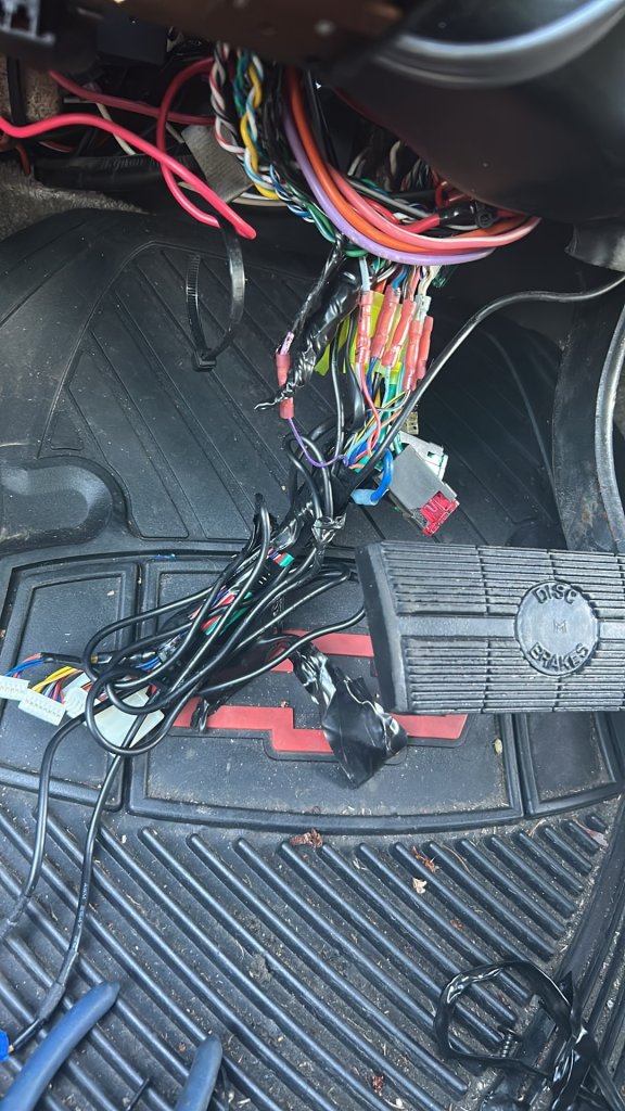

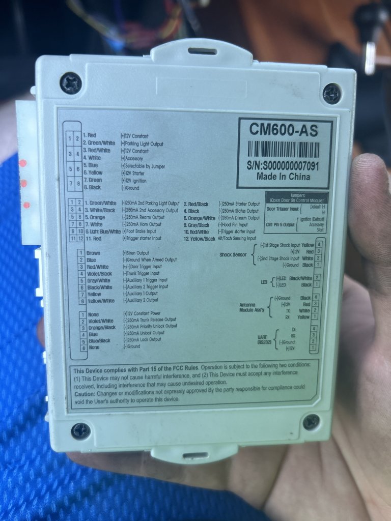

So uh… guys… I found my potential problem… it goes EVERYWHERE

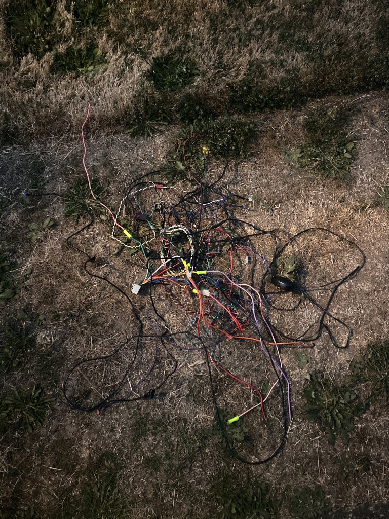

Got it all tore out last night. Like a physician dissecting cancer from a healthy body.
