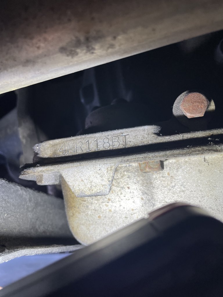

100% not... unless you have 4.56's... which you would DEFINITELY not be able to confuse for 3.08's.
Take a picture of your transmission pan and post it here. Go out and drive your truck and record the speed and RPM of every shift. You can calculate the gear ratio from those numbers. I bet you find that you are not getting into 4th

The bottom of the pan... so that we can see what model it is.
Does that partial VIN stamped in the rail match the truck? If it does, you can also verify by looking at the RPO's listed on the SPID sheet inside the glovebox or on the fenderwell.
