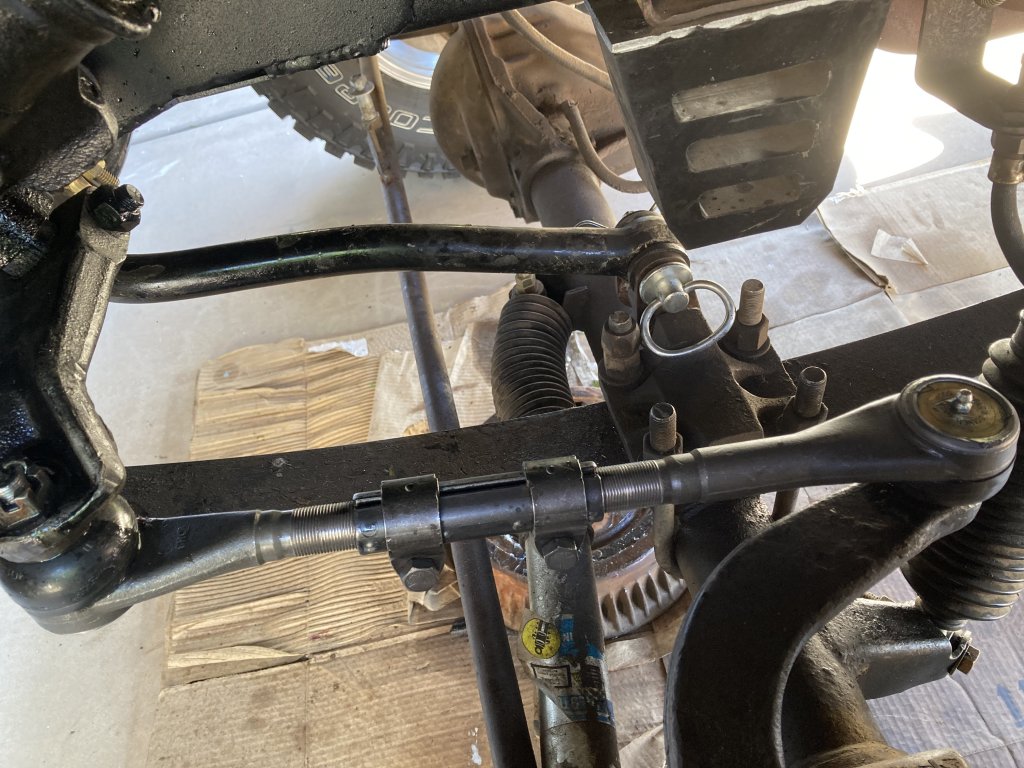

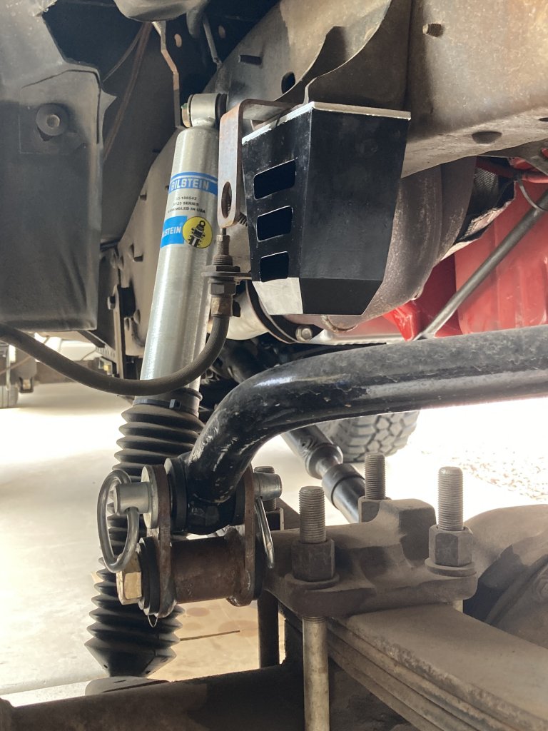

I have the ORD sway bar disconnect. 4" lift on 35's...works well enough.
Where did you get those bump stops?

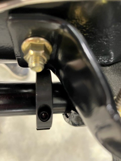

And, did you have trouble with the ORD sway bar locking collars? There is no clearance on my frame to mount next to bushing. As a matter of fact, my frame doesn't look anything like what's shown in the ORD instructions.
The bump stops I got from ord. But they are standard energy suspension as far as I can tell. The install of the sway bar along with engaging and disengaging have produced no issues thusfar.

Thank you. Does that mean you didn't install the locking collars? I have 6" ORD springs and was thinking those bumpstops you have look pretty nice.
