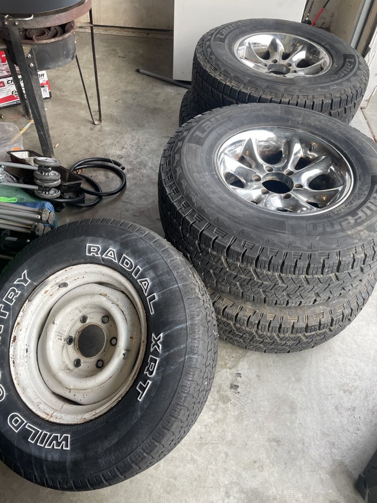

Looking to put a 4 inch lift got quoted 1400 to take it to the shop with a rough country 4 inch lift kit any other kits that are recommended and would need new tires or would these 265/75/r16 be fine?

Tough country has lifts also. I don't have a lift on my 85 truck so can't speak from experience. From what I've read the ride will be rough with that brand. It's in the name :). Those tires will be a bit on the small size with a lift. I'm running 32-11.5-16"s on my truck. In reality none of the kits will give you a great ride, but hey it's a solid front axle truck. I found that shock choice makes a difference in ride quality. A stiff gas charged shock will be much more unforgiving then a hydraulic type on paved roads.

You can run what you want for tires but you're likely going to want at least some 33s.

Probably 35’s on a 4” lift. Skyjacker 2.5” on mine. Replaced a Rough Country 4”. Pleased with the outcome.
