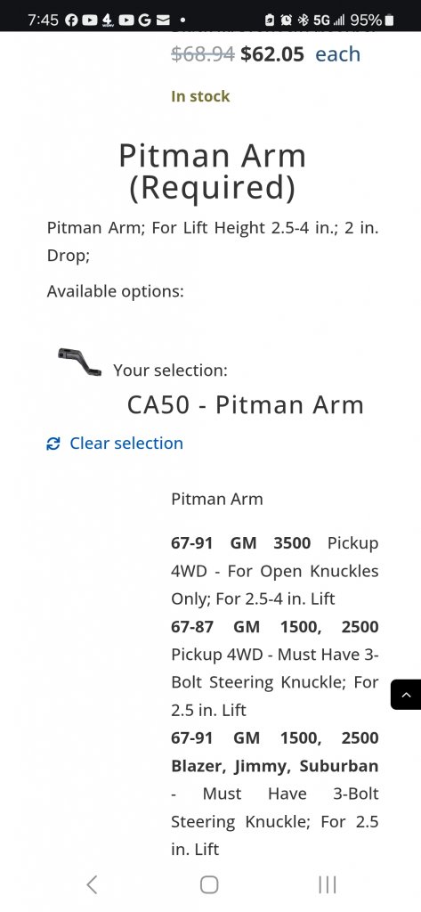

Thanks for the reply and all the good information (i like details). I think I'll order the kit with rear blocks. A person could always change springs later.
Looks like skyjacker "requires" the drop pitman arm, but I have never used one on a square with less than 4". Are yall running factory pitman arm?

I am running the factory pitman arm. Since I removed one leaf from the front stack of springs and my lift is actually about 2" my pitman arm is still pretty much level. I thought/think that a drop arm is not required until you get around 4" of lift. But I could be wrong.
I have always thought there was no steering correction needed until 4". I just noticed this when I was looking up the kit on skyjacker.com. I have had 2-3 lifts on other trucks with no issues, so I think I'll go with my stock pitman arm. Thanks again
